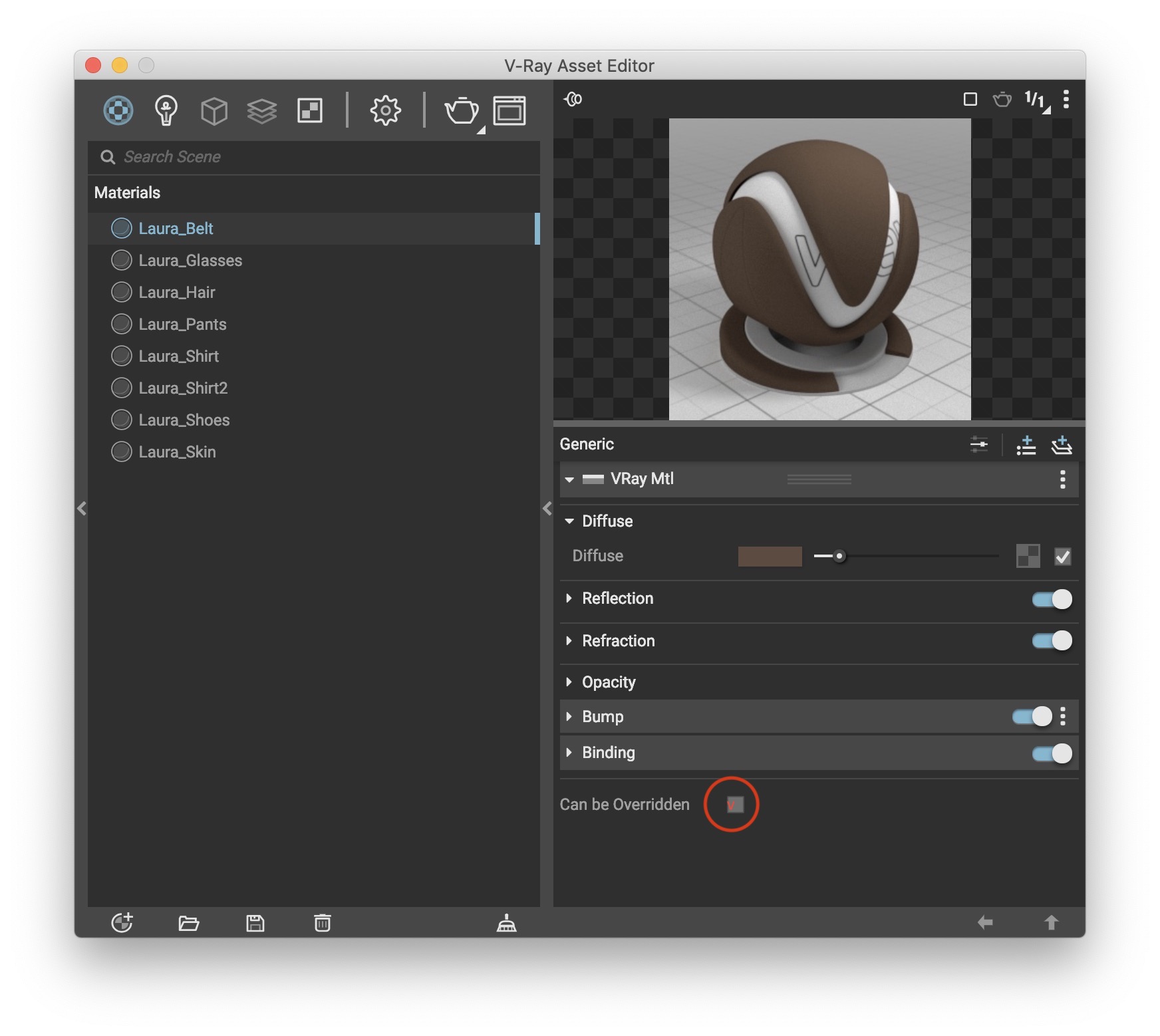

Try posting on Chaos Group’s forum as well since they may have seen this error more often. To find the bad material, start by turning ‘Material Override’ on, then you can, one material at a time, uncheck ‘can be overrriden’. Try doing a low quality draft render to speed the process up. Go down your materials list and see if one causes the crash by itself.

Hi, thank you so much for the explanation. I am actually following the advice from @eric-s and I have enabled Material Override and I am unchecking and rendering one material at a time… so hopefully this will be IT for me. I unchecked the drapes a little earlier and they seem fine so far… but who know.
You were right! It was several bad materials… which I have removed and hopefully when I re apply them I won’t have the same problem. Thank you very much :slight_smile: !!!
