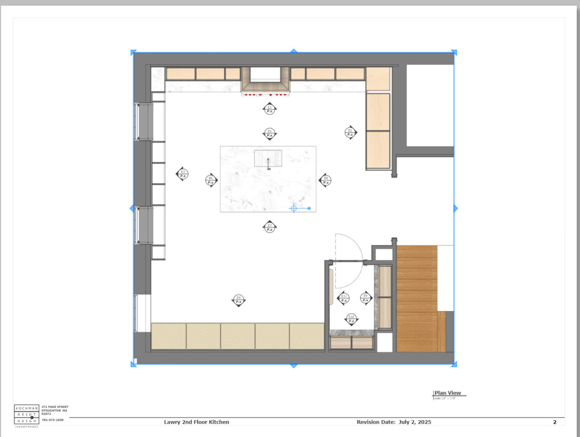

I am on a new MSI laptop, and everything was going well until I tried to update the model reference in layout. The viewport goes blank, and I can’t even double click in to see if I can find the model to place it back where it belongs.

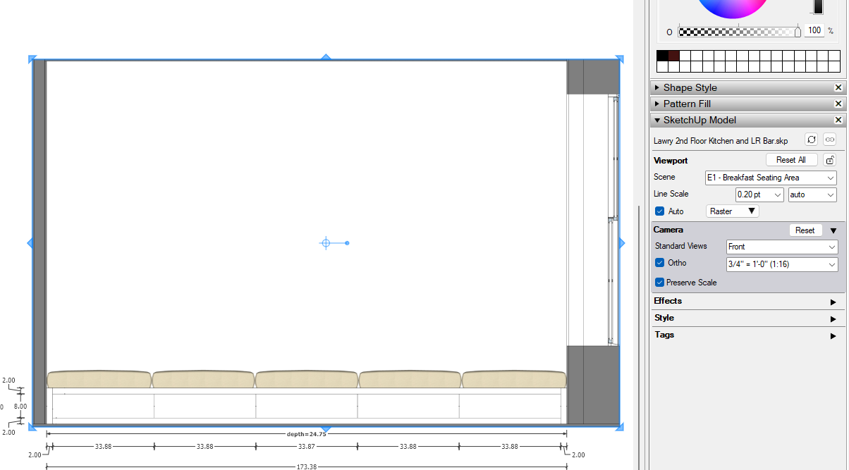

I have not modified the scenes in layout however the Camera panel would have you believe otherwise. This is just happened yesterday afternoon. It opens to what you see below, which looks fine, but when I update the model reference, everything disappears for all viewports. (There are only 2 so far in this file).
Can someone help figure out why this is happening and why the Camera panel says the viewports are modified when they are direct imports from the model?

The Viewports do appear to have been modified, perhaps they have been panned to center the model? Try using the reset all button at the top of the Sketchup Model window. The model will disappear, then in the same window choose a different scene for that viewport, then switch back to the scene you wanted. This seems to trigger a redraw, I’m not sure why. If you need to pan move the sides of the viewport rather than double clicking into the viewport to avoid the modified state.

I don’t have the Reset All option.
What do you mean by that?
Nevermind, yes I do I was just looking at the Camera panel and not the model panel. That seems to have fixed it. Thank you!!!
