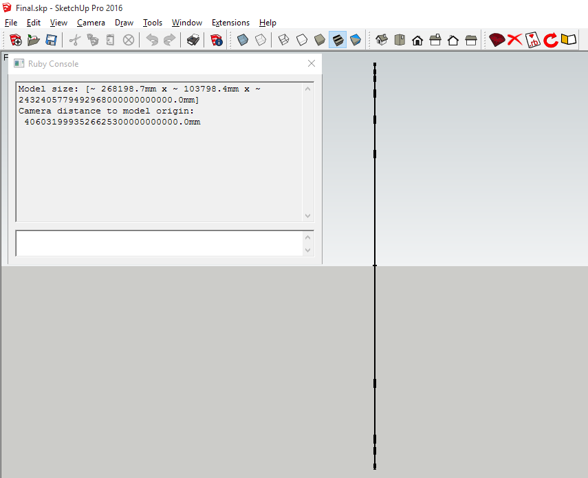

Urgent! please help! tomorrow is my deadline and my entire model is disappeared!
Thank you Shep. Can u send it back to me in version 13?
Haha You have managed to create a model 257 million light years in height. Well done. Fortunately, no data was lost.

Something further for you to consider: you can see in DaveR’s screenshot that you have the origins of many components located at a considerable distance from their contents. This will put you at risk of clipping and inference snap issues. At this point you have a lot of components, so it will be a pain to change the axes for all of them, especially if you are under a deadline. But for the future, it is something to bear in mind. Data imported from CAD is especially susceptible to coordinate origin issues in SketchUp.
