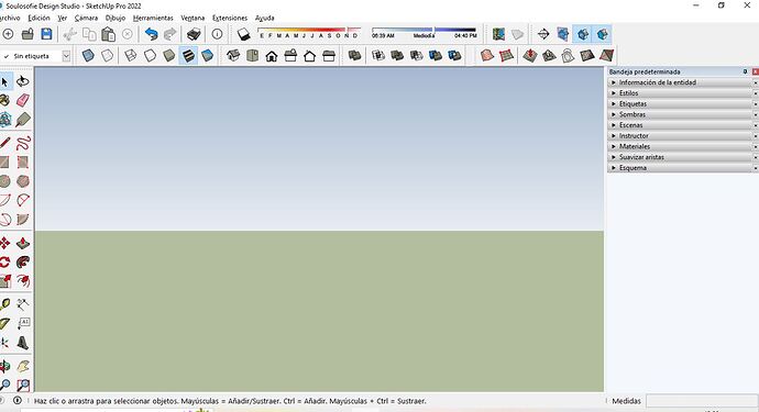

Hi there, I’m struggling to see my model on sketchup 22 desktop version and I’d really appreciate your help.
I was working on a model and suddenly it was gone.
I can not see anything else than this.
It’s blocked. I cannot zoom out or in at all.
I’ve been working hours and I wouldn’t like to lose all the work
I’m afraid of saving it so i lose everything

now i can’t see anything but the screenshot attached
i saved a copy of it and when opening it, it says that the file is blocked by another user.
it can only be opened on reader mode.
it says that the skp is too big, how can i send it to you?
Looks like you managed to get the camera at a huge distance from your model. Maybe due to somethingyou had imported from the 3D Warehouse?
I fixed the camera and your model shows up. I also fixed the incorrect tag usage. ALL edges and faces should be created and remain untagged. Only groups and components should be tagged.
I also purged unused stuff from you model. You should be doing that regularly. This reduced the file size by about 63%. Remember that just deleting components from the model space doesn’t remove them from the file. No point hoarding furniture and other components that you aren’t going to use.

I understand that one thing that makes this happen is if the Warehouse model is geolocated. Why someone would geolocate furniture is beyond me, but it seems to happen.
