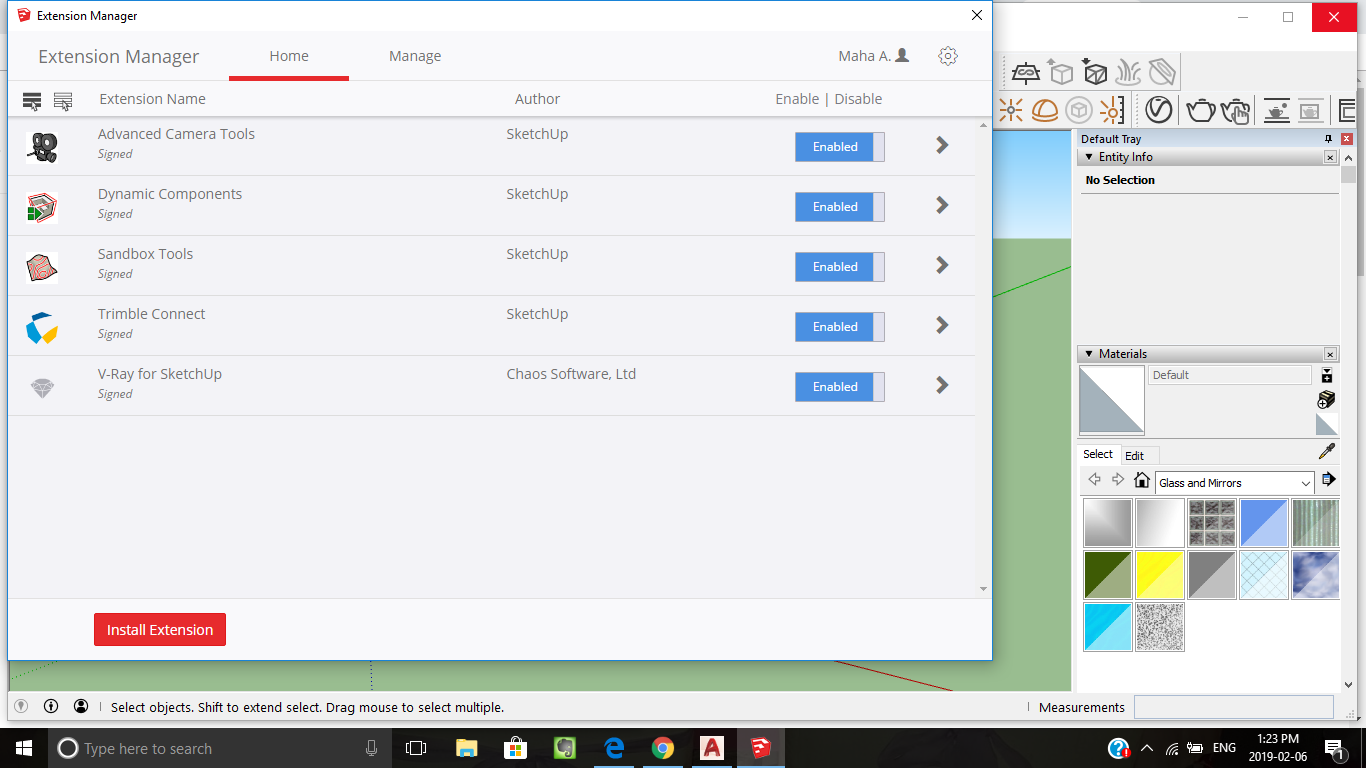

Ok… so I have another question. Have you downloaded / used any extensions on this model? If so, can you capture a screenshot of your Extension Manager window? Also, would it be ok if you shared your file to a service (Google Drive, WeTransfer, Dropbox) for us to test out?
So because I am not able to view anything on my corrupted sketch up file, I took a screenshot of the extension manager window of a new file I just opened on Sketch up. Before the file corrupted, I was trying to renew my vray license that I just purchased, but it was not working because my Dongle USB has expired and I needed help renewing my dongle USB. That is when my file suddenly shut down and did not open it again, so I’m not sure if this had anything to do with what happened to my file.
