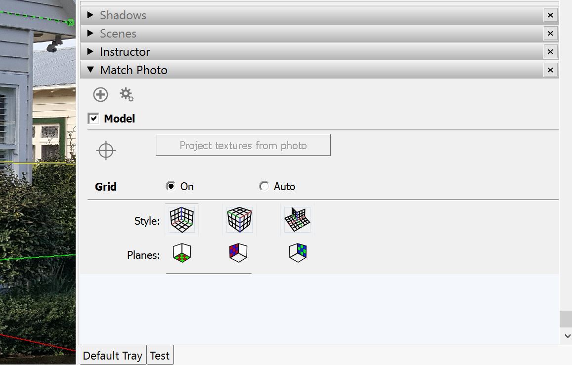

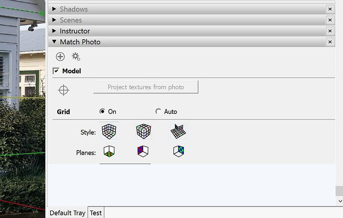

You can see the bottom part seems to be missing (the Spacing box and the Done button aren’t visible). I’ve tried scrolling, clicking, dragging… I’ve repaired the SketchUp install and Reset Workspace, and adding/removing the Photo Match from the tray with no joy… It used to be visible, not sure what has caused it to go like this. I do run a second screen on the laptop and wonder if swapping between single and dual screens may have got it confused - the problem exists on both screen configurations.
How much of the screen are we actually seeing in the image? The tray seems to be very big.
My immediate suggestion would be to give Match Photo a tray all of its own, so that it doesn’t have to compete with all the close tabs above it for screen real estate…

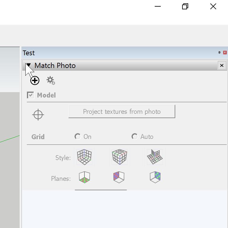

Thanks Alan. The s/shot above is a small snip of the bottom right of the screen. I did try creating a new tray and adding only Match Photo to it, but same result. Its like Sketchup underestimates the height of the Match Photo thing and cuts it off… you can just see the top of the Spacing box…
There’s not much more of the dalog box to display…but on closer inspection it looks like there’s a pale blue mask in front of the dialog, rather than the tray actually finishing. The border continues down on the left. It seems that normally all you should see is a few pixels of that lighter blue right down at the very bottom.
