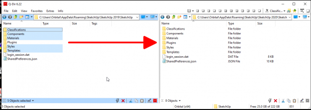

I keep my local collection of components, custom materials, and styles in the User/…/SketchUp file and copy them from one version to the next. By default SketchUp is going to be looking there for these files.

As an alternative, you could just go into SketchUp’s Preferences and change the file locations to wherever you keep those things. I just prefer the way I do it.

Interesting, I do as well, but I have not been able to migrate components this way. The transferred components do not show up in my components window in the next version, I assumed because they were created in a previous version. This works for you?
Are you copying the folders from the older version’s locations to the new ones? On both Windows and Mac these are normally hidden locations . On Mac: ~User/Library/Application Support/SketchUp/…
On Windows, all I have to do is copy the folders I show highlighted over to replace the ones the new version creates. When I open SketchUp the next time, those files are automatically available.
