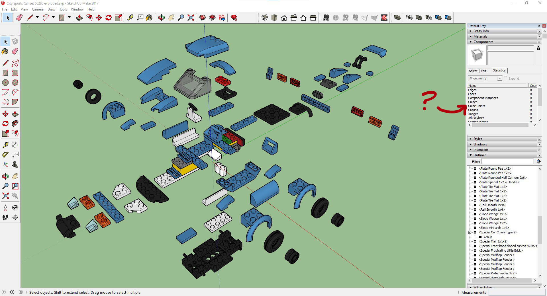

Here’s a quick, dirty, and random exploded view i made.
For some reason the stats tab is zeroed out in all of my models. Not sure why.
I’ll have to look it up.
Enjoy!
That’s statistics information is for a selected component. You haven’t got a component selected in the Components panel before going to the Stats. If you want to see the model statistics, go to Window>Model Info>Statistics.
