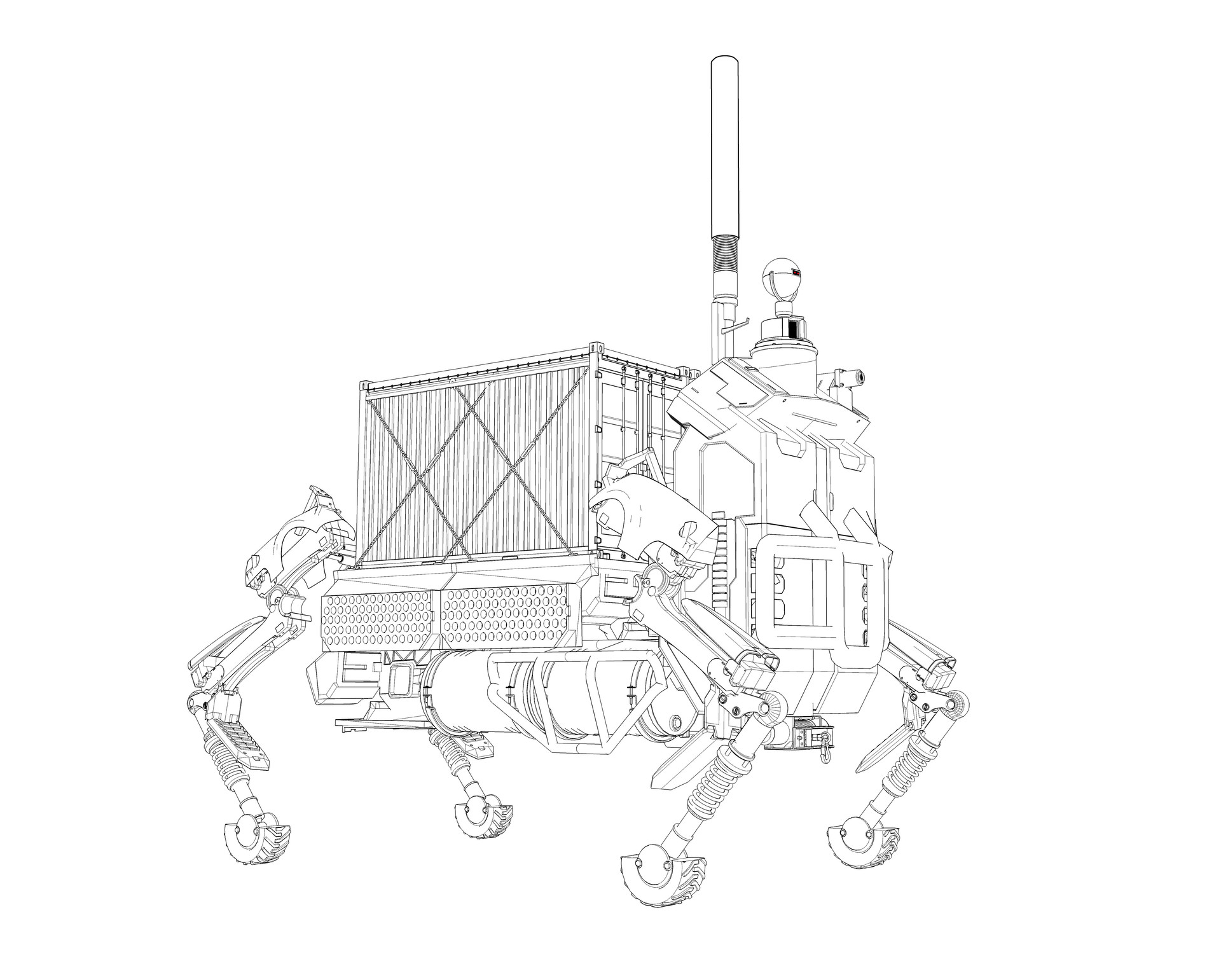

I posted these previously but they are examples of just sketchup linework:
Thomas the mech, childhood friend updated.
