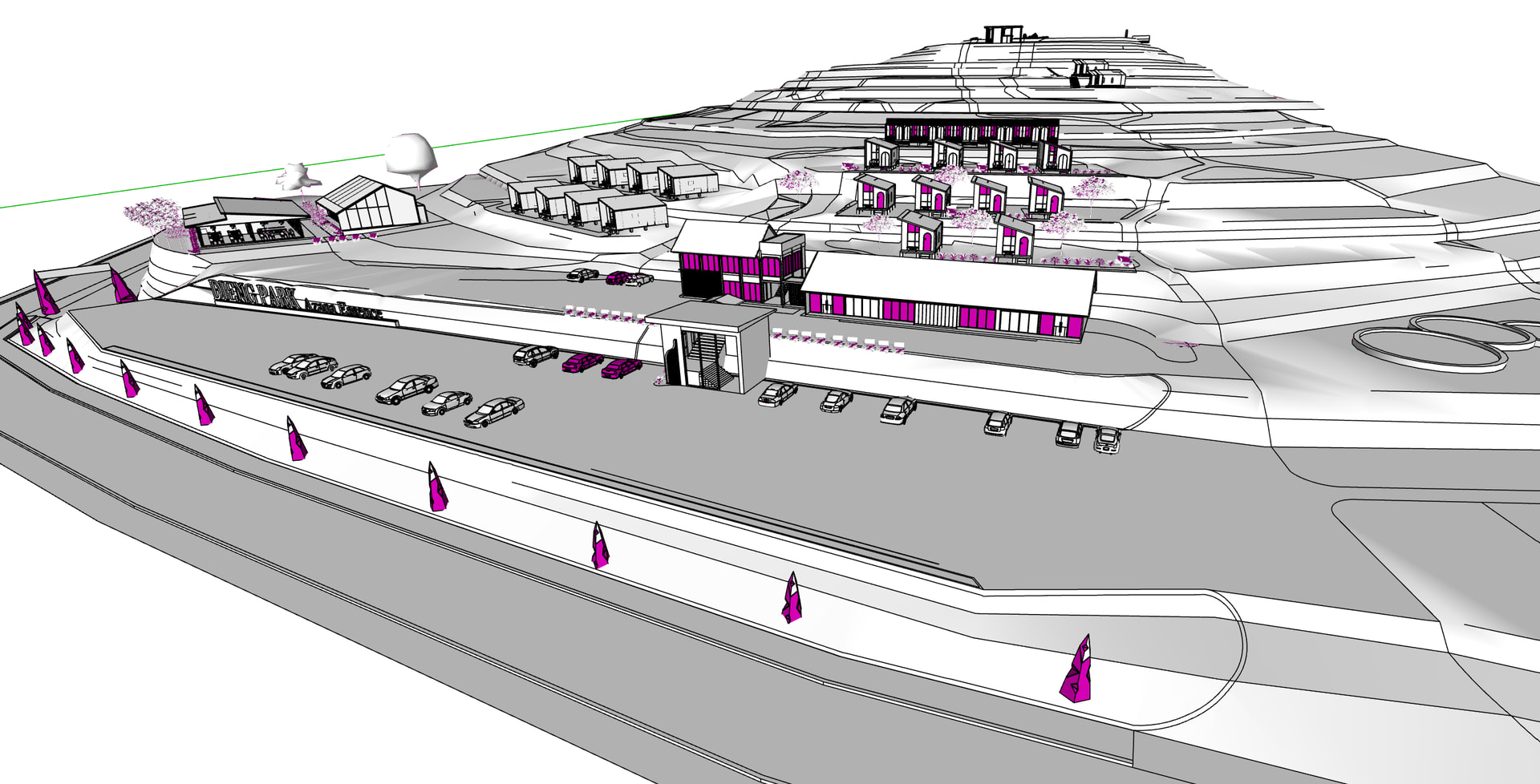

You´ll still have to fix reversed bak faces, I changed the color to pink to make it more noticeable the back faces.
