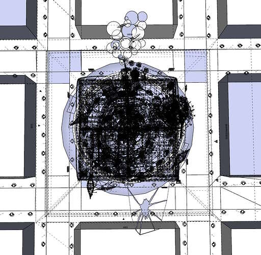

I was wondering for another way to reduce the total size of my model
It is 50 x 50x 50 in cm in real size! It has MANY details 18 levels loads of glass
When I display wire frame only
and then go back to shaded with textures it takes more time to go back
than to close the model and reopen it.
I want to know how much % can I reduce till it looses quality?
In the moment the model has 118 million polygons.

Xray causes ALL THE GEOMETRY to be visible through different levels of transparency.
OFF COURSE your PC is suffering and taking time :sweat_smile:
It’s like printing your 118million word book on transparent paper and then complaining that you can’t read because it’s too much.
