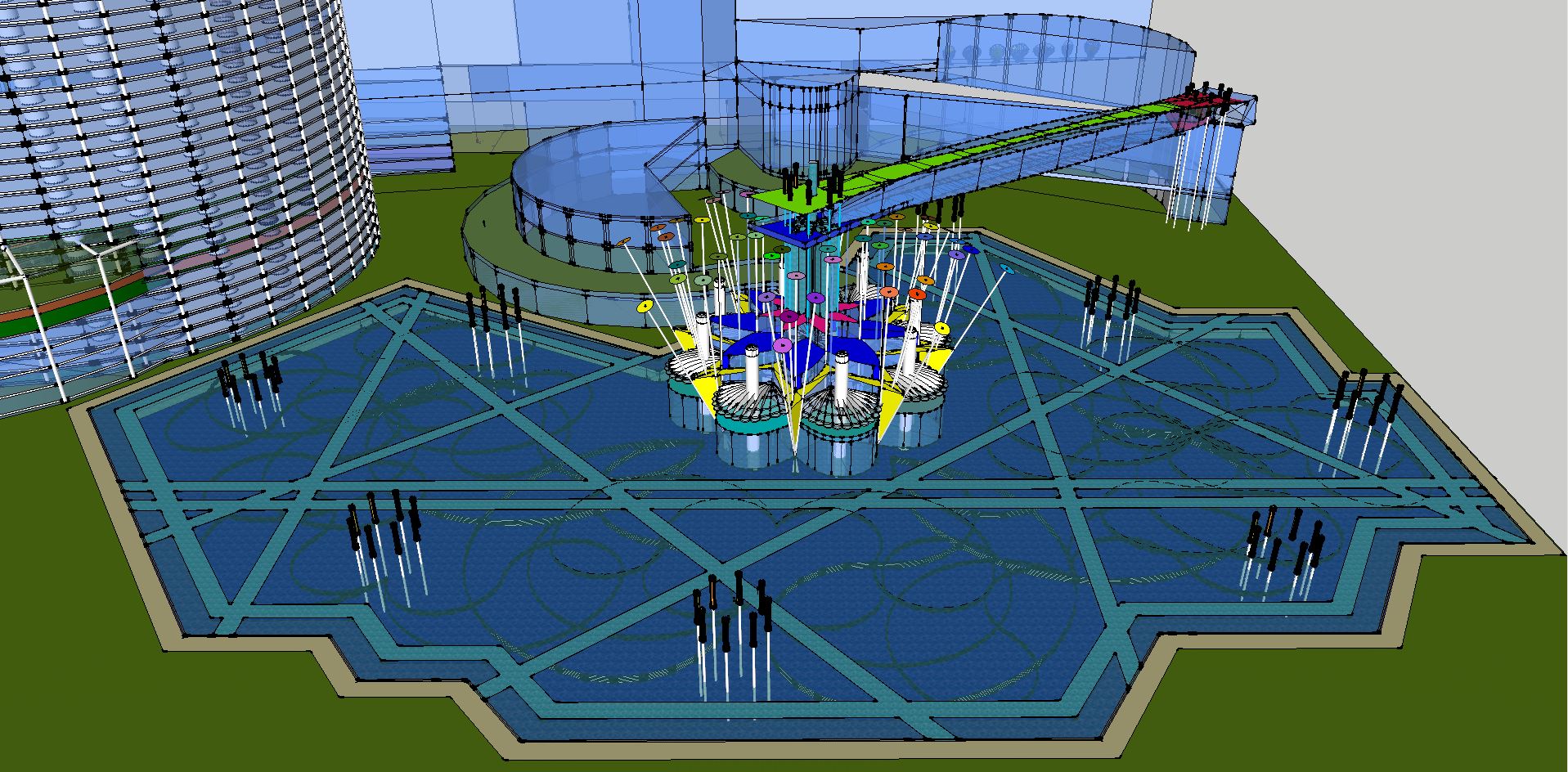

I opened my last file of my huge concept Ying Yang Project all went OK
now another day that I want to open again a HUGE part of the project is sort of INVISIBLE

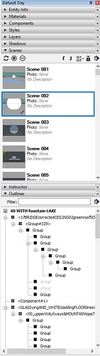

I watched a youtube Managing Groups and Components in SketchUp with the Outliner - The SketchUp Essentials #18 - YouTube
about OUTLINER .
I must admit I never ever used (mea culpa) (but I did name many groups (not all but many)

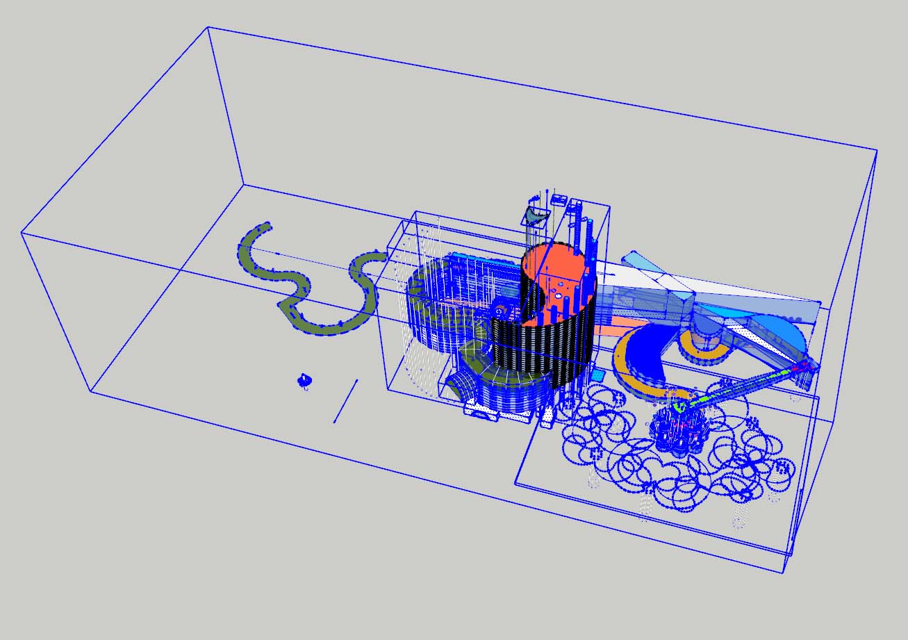

I made a screen shot of what I see basically most of the upper part of the concept is missing
I can’t tell how many groups I have I see some groups that say (#437) I don’t know does that mean I have 437 groups in my project? It’s very possible. It is 60+ storeys tall with malls condos bridges lake waterfall very detailed swimming pools, jaccuzi, malls, mini golf etc, a convention centre and a Dubai type dancing waterfall also ALL my support land is gone. and the 8 floor underground mall

One thing is evident; you are using layers incorrectly. Layer 0 should always be the active layer. Your first screen shot shows you aren’t doing that.
It could be you have hidden geometry or a layer or layers turned off. One thing I’ve seen others do is mistakenly hit Erase instead of Hide in the Context menu. If that happens with groups or ungrouped geometry and you don’t catch it right away, that stuff is gone and you would need to create it again. If that stuff was components, though, you could pull new instances out of the In Model Components.

Hello Thank you for your reply.
I don’t know why, I just re opened the SketchUP trying to look at layers again etc.
and the entire file was visible again.

The screen shots of the (four) extensions names are in the picture of the screenshot.
