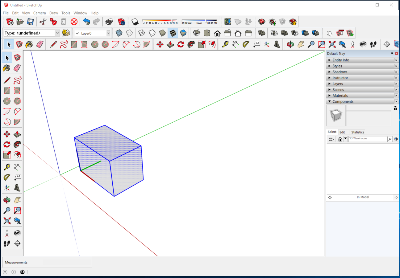

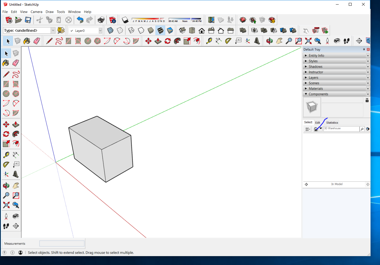

Before you create the component try opening your component window and clicking the home icon to bring up all of the components currently in the model.
Then try to create the component.
So do you ever see the “Create Component” dialog appear ?
nope.
