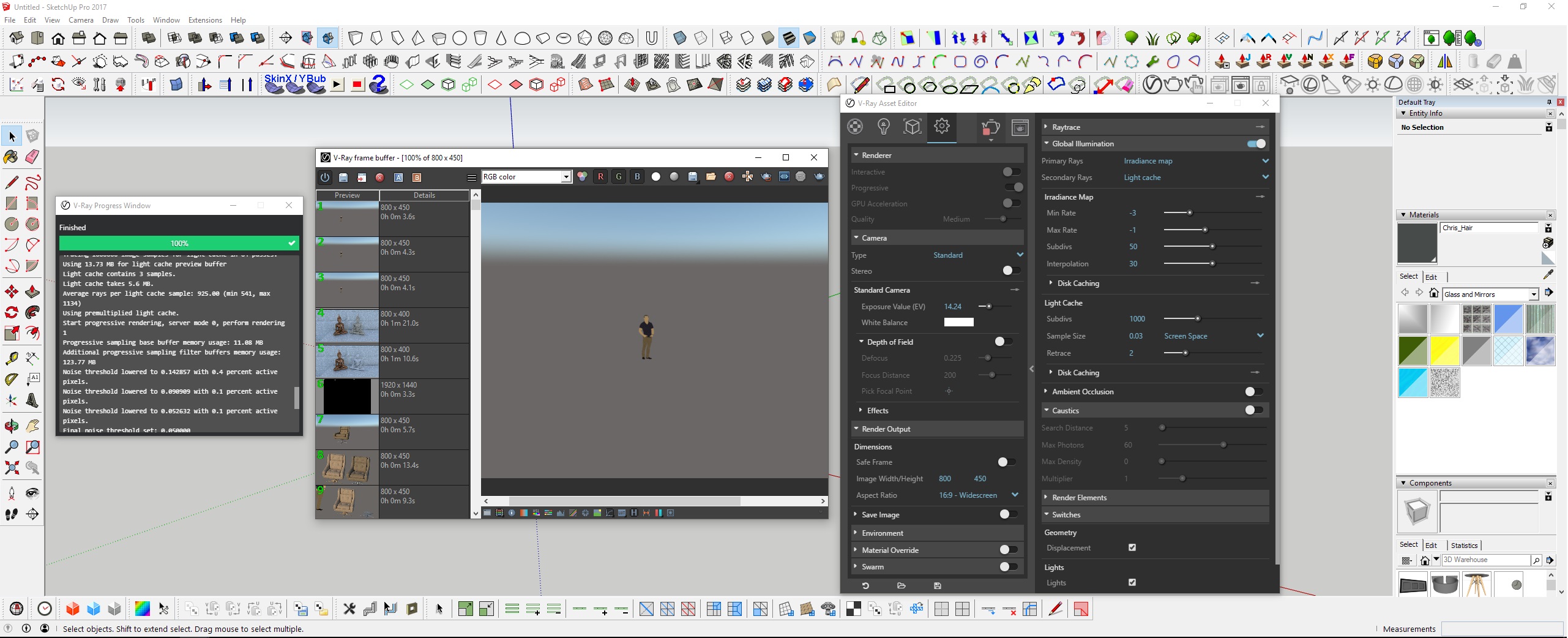

SU 2017 + Vray 3.4 render problem
Hi, I’ve got a really big problem…
When I want to make a render or a render interactive with Vray (settings by default), the render seems inactive, and nothing appears.
Sometimes a color appears, or a texture, like on my pics… but never anything else.
Whats the pb? Did I make some mistakes?

Where and how?
All the settings are by default… I tried to change some things on the camera and ouput section but nothing has changed, what should I do?
