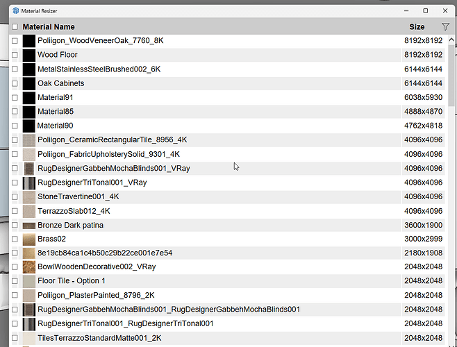

By the way, it would probably improve rendering speed and other things if you clean up the model. I fixed incorrect tag usage (frankly, I expected more incorrectly tagged geometry) and then reduced the size of the excessively obese textures.
That improved performance on my machine and reduced the file size by better than 35%.
