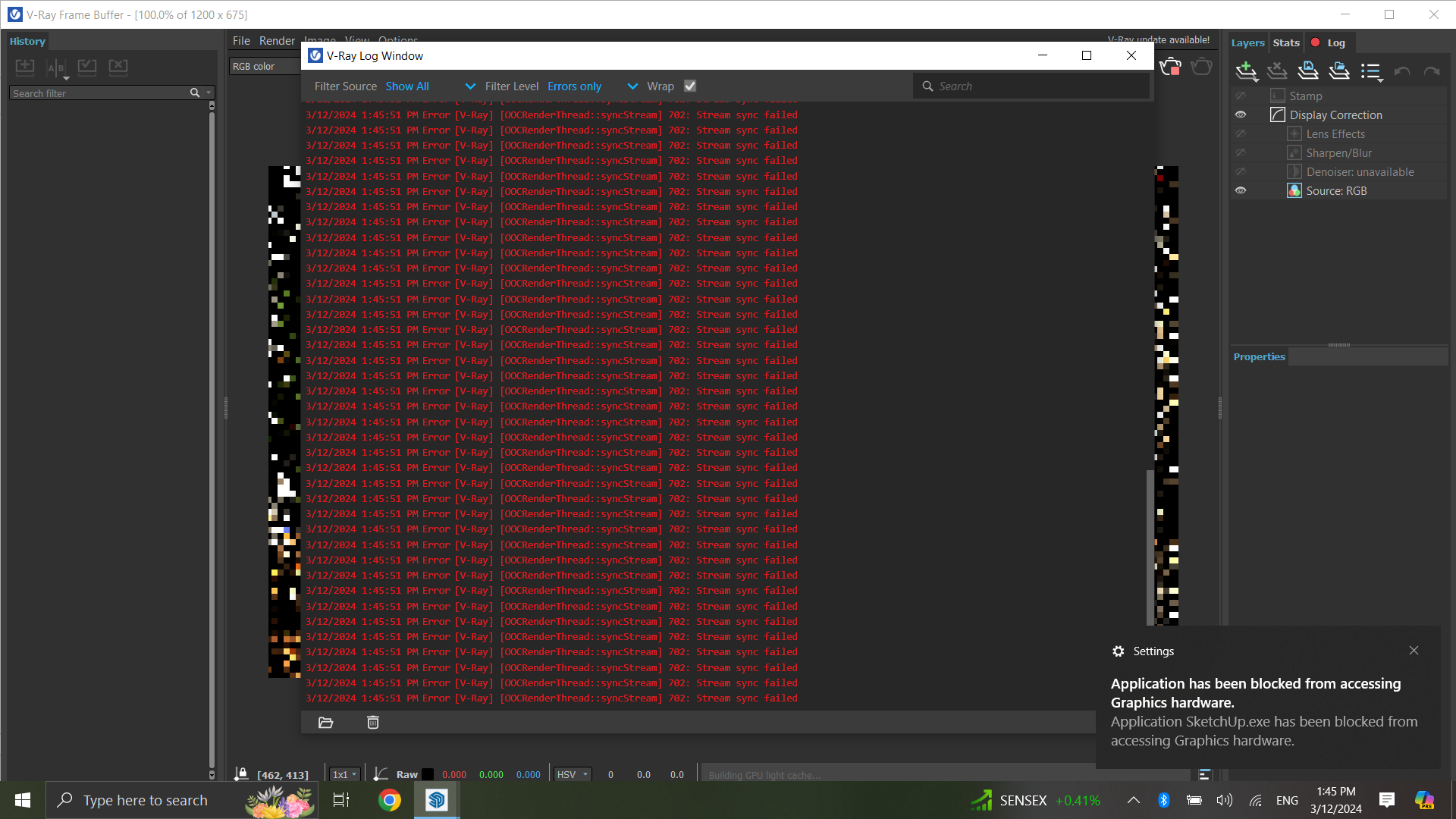

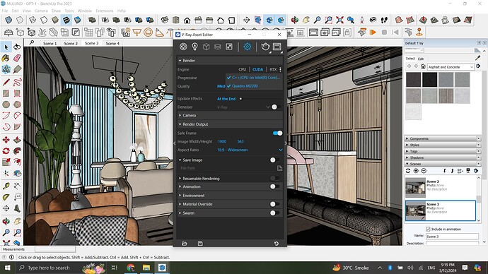

Hi, My vray keeps crashing saying all this errors. Can anyone please explain why does this issue happens? My sketchup file is approx.200mb. I’ve attached screenshot of my device’s specifications also just in case it’s needed. I tried with low quality render also I deleted unused materials light everything but still it keeps crashing.
It must be because my nvidia processor is not updated? And not because of any other issue? It was working just fine in the morning & suddenly after few minutes this issue is happening
That is just one possibility, rather easy to check by updating the driver and seeing if the crashing persists.
Also check that your Vray is up to date. The newest version is from late January.
