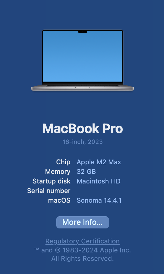

Since upgrading every time I open SU 2024 it crashes at least twice. Opening a model or not opening a model it just crashes every time on start up. Then when viewing an open model full screen it forces my computer into a reboot. When that happens the screen blacks out when I enlarge the project window and then after a few flickers reboots (only on external monitor usage). Now I get a message on start up that it’s defaulted to the classic graphics engine (see picture). I am at a loss and completely frustrated at this point. This is after I wiped everything from my drive and did a clean install of SU 2024 and still the same problem.

So after hours of trial and error Ive found that I can work with SU and not have it force restart my computer if I keep my external monitor at certain resolutions (direct connection or thru a hub). SU is the only program that does this. I have tried many apps that are GPU intensive and nothing else dit it. Maybe its a SU bug or my laptop but I wanted to put it out there to see if anyone can help or if they are having the same issue. I wiped my laptop (do it annually) and did a clean install of Sonoma and SU and it crashed the computer. I found the way to make it work for now. Other than SU crashing 2-3 times every time I open it all is somewhat stable.

MBP M2 Max (See Above) - Each testing scenario - connected via HDMI directly, thru a Caldigit Thunderbolt 3 hub and a Thunderbolt to HDMI cable.
Monitor - BenQ 3200U 4K 16:9
Runs fine at 4K, 3200x1800, 2560x1440, etc.
In my display settings I have about 13 resolutions to choose, 3360x1890 was the one that caused the issue. It’s the first lower resolution down from 3840x2160 and Ive used that mostly because 4k text scaling is too small for these tired eyes.
I hope this helps. Again it may be me or my machine, just letting you know what Ive found. The crashing every time on startup, no extensions installed, is still there.
