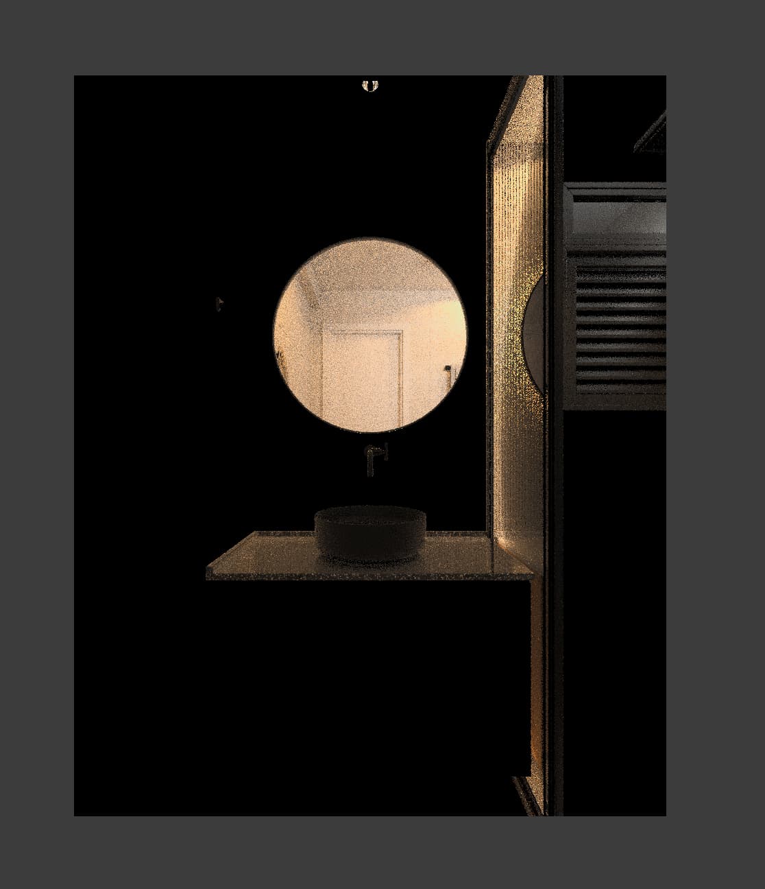

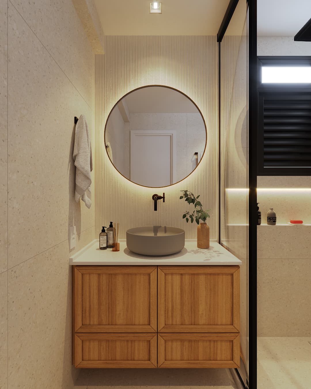

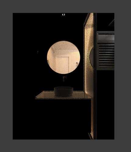

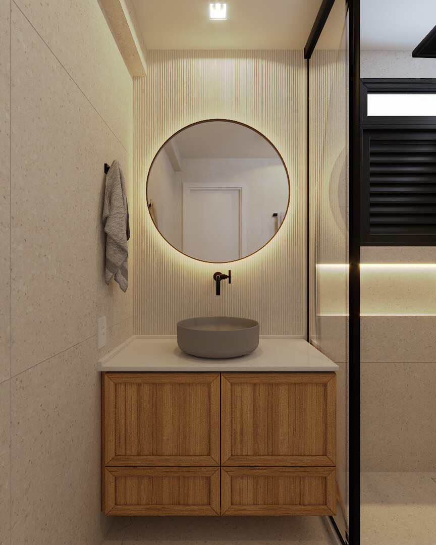

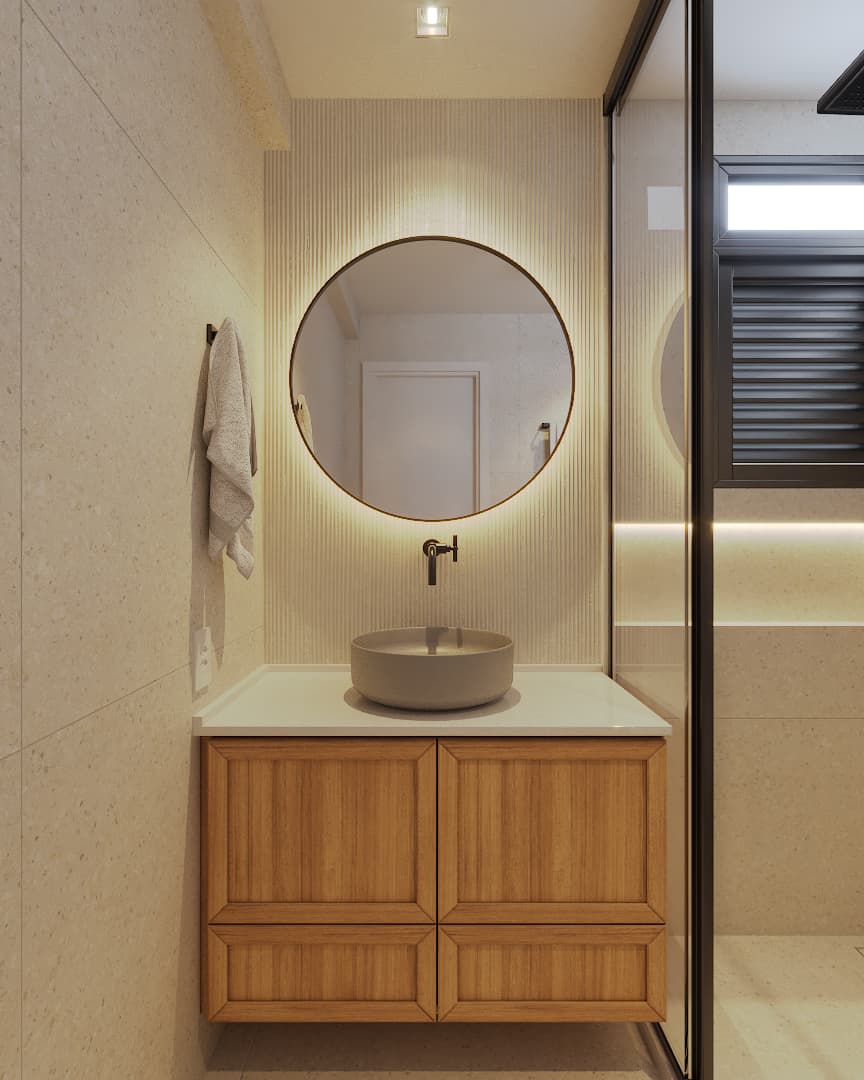

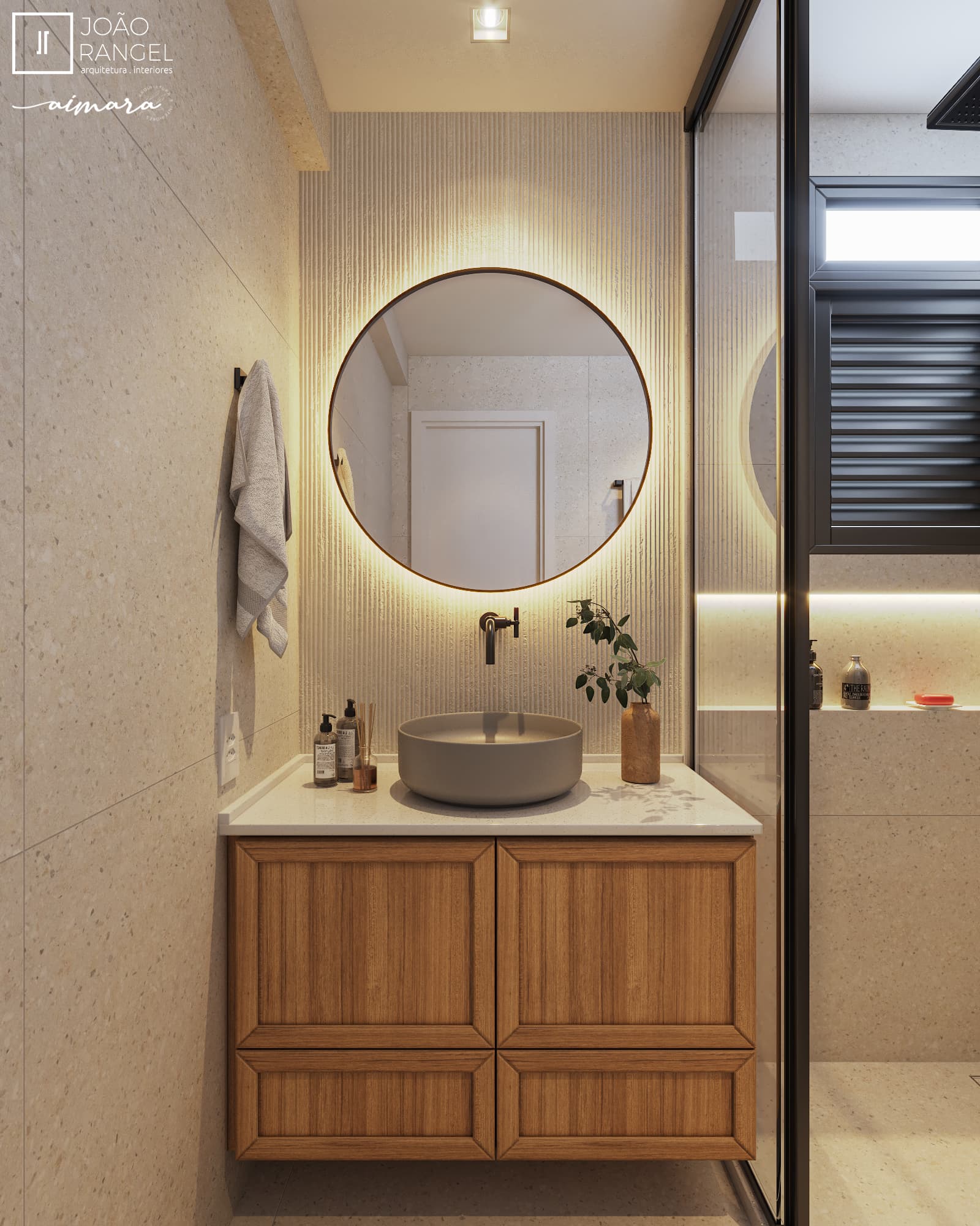

I have already tried a clean uninstall of both SketchUp and V-Ray, but the problem persisted. Below, I will send two scenes for you to see the difference, the first one rendered with V-Ray 5 and the other with the latest version:
V-RAY 5
V-RAY 6
See how materials with reflections behave differently, especially the black metal.

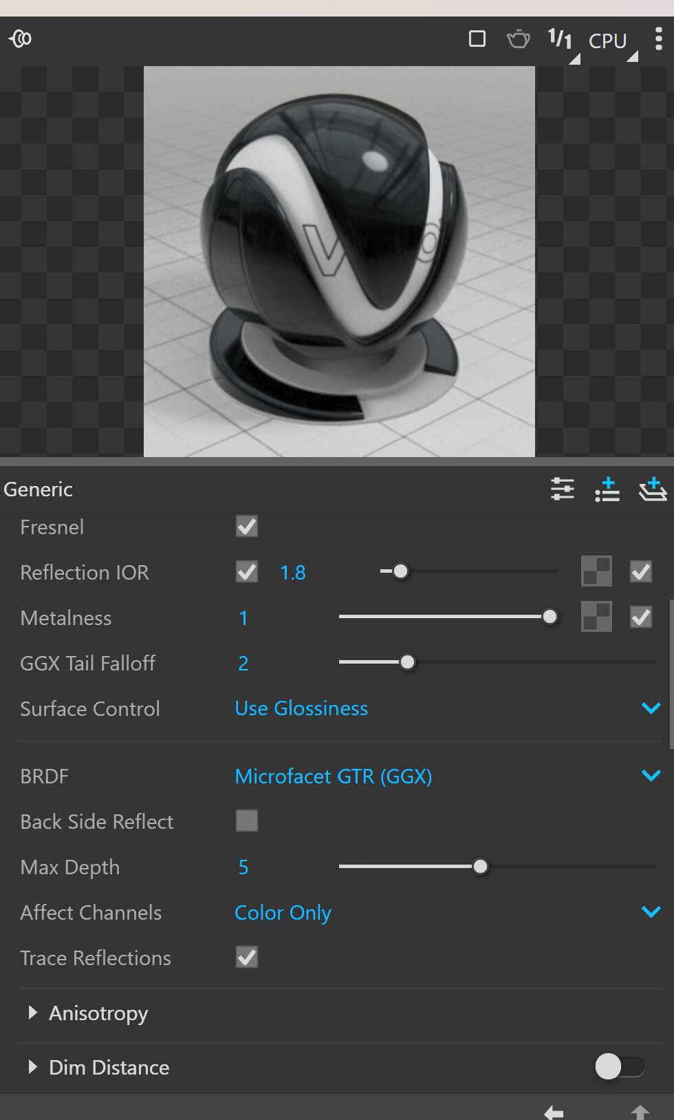

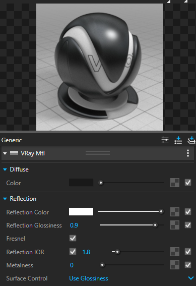

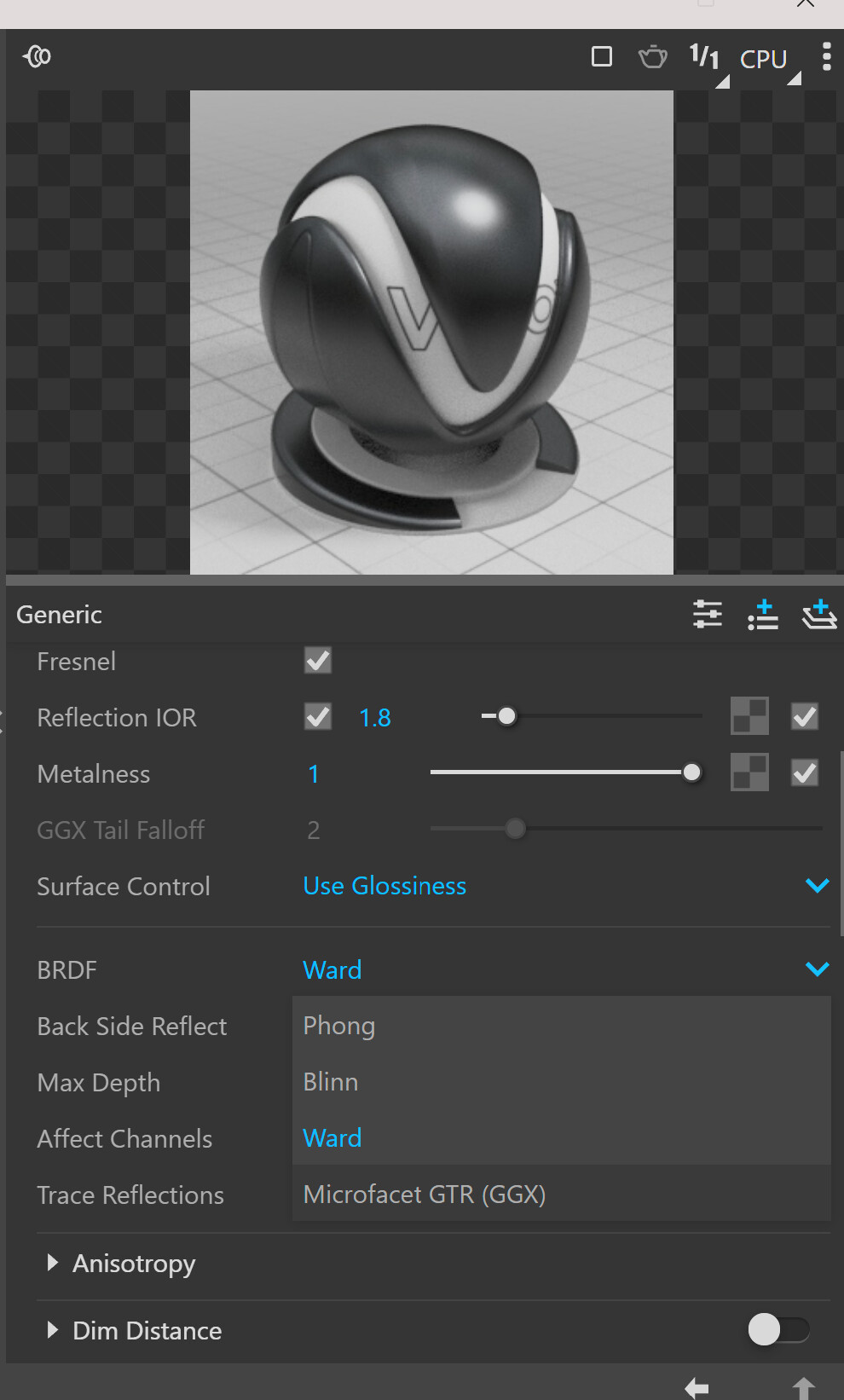

Here is its configuration.
Yes, that’s the point. Reflection layer is messed up in V-ray 6 for me :worried:
They improved the algorithms in vray 6 for reflections, but as you have a material made of fantasy properties , that might explain why it looks so different.

I’m not sure why, but your BRDF is set to WARD
It should be on Microfacet (GGX) , unless you set it otherwise.
When I create a new generic material, I get the GGX by default also.
I like the effect of using the BRDF in WARD when I make metallic materials, but that’s not the point. The behavior is different in all materials, using any mode in the BRDF.

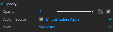

I removed the Dirt from the Diffuse slot of the ceiling material, but the same problem persisted. So, I reviewed the parameters of this problematic material and found an unusual option activated:
It was marked like this in the opacity layer, so I reset this setting, and even with Dirt activated, the entire scene returned to normal now. :star_struck:
