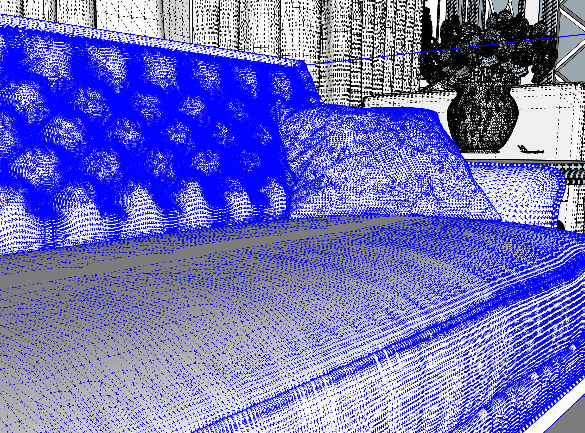

Look at this monochrome view of part of the sofa, with hidden lines visible:

You could get a model that would render equivalently with FAR fewer edges and face.
That kind of thing is what is slowing down both your modelling in SU and even more, the rendering.
There are some plugins that can help simplify over-detailed geometry, or you could learn to draw them yourself more simply.
Or use the tips in the previous post to simplify your model.
