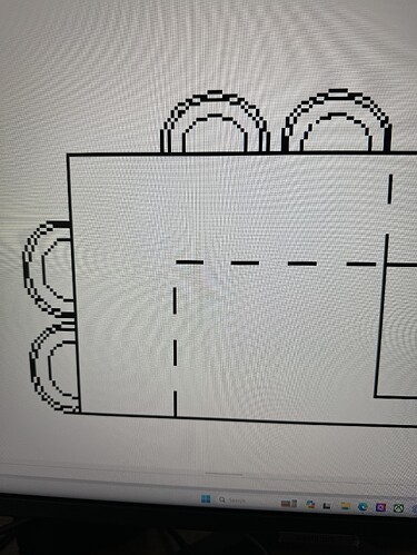

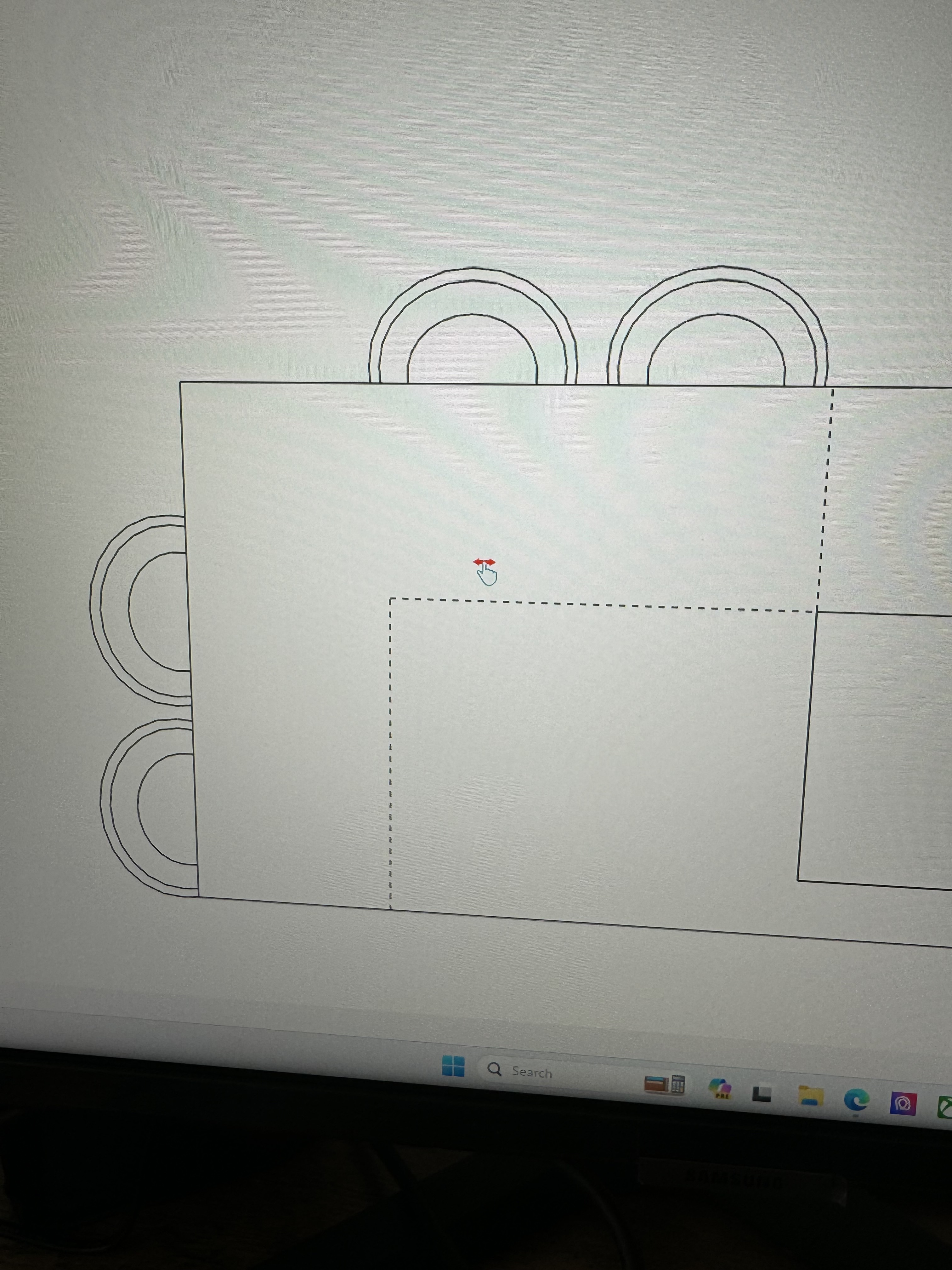

I watched a tutorial that there are settings to amend the quality of the lines in Layout to look the same as in Sketchup but I can’t find that tutorial now.
So, once I send my model from Sketchup to Layout the lines are not straight.
Please see two images attached below.

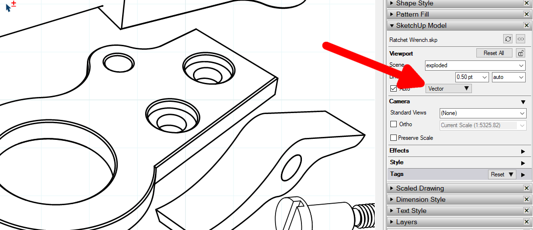

Select the viewport and in the SketchUp Model panel, change the rendering from Raster to Vector. Keep in mind that Vector rendering is slower than Raster.
To reduce the jaggy look you can also increase the rendering resolution in Document Setup. That looks like Low.

Unfortunately, it didn’t help. All settings on high resolution.
Why don’t you try what I told you to do an hour ago?
Ok, it worked when I changed to Vector. Thanks
