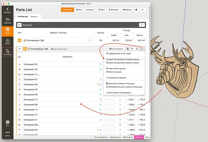

Maybe you can try the OpenCutList extension which allows you to export each part into a separate DXF file.
After that, you will be able to import each part as you need.
This will allow you to use nesting tool like NestingCenter, for example :
And maybe in a near futur, with the next 7.0 release, it will be possible to compute nesting in OpenCutList directly :wink:
And export the whole cutting diagram as DXF :wink:
