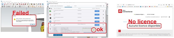

Je viens d’acheter l’abonnement SKETCHUPSTUDIO pour avoir l’extension V-RAY mais lorsque je veux utiliser V-RAY dans SKETCHUPPRO je reçois un message d’erreur me signalant qu’il n’y a aucune licence V-RAY détectée (Failed to checkout a V-ray for SketchUp license)

We have uninstall and erase all sketchup version and V-Ray version, We have erase all sketchup folders and V-Ray folders from every folders. I reinstalled sketchupro 21 and V-ray by following the recommended procedure but the problem is still the same …There is still no license on CHAOS, the problem comes from CHOAS, between TRIMBLE and CHAOS or between CHAOS and my V-ray installation … please help me.
