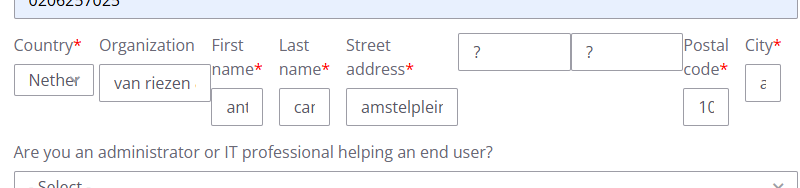

I just sent the service ticket.
Not sure if this is as attended, but some of the input fields seem very small?
And no clue what to enter at the two fields without info, see the fields with “?”
