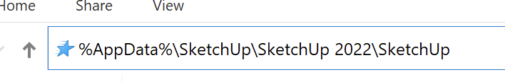

I tested the steps I gave, and it does work. Select this text and do a Copy:
%AppData%\SketchUp\SketchUp 2022\SketchUp
Open a File Explorer window, and click in the path field, where it might at first look like this:
Paste, so that the path now looks like:
Press the Enter key, and the path will fill in your user details, to take you to the right folder. Find the login_session.dat file, and delete it.

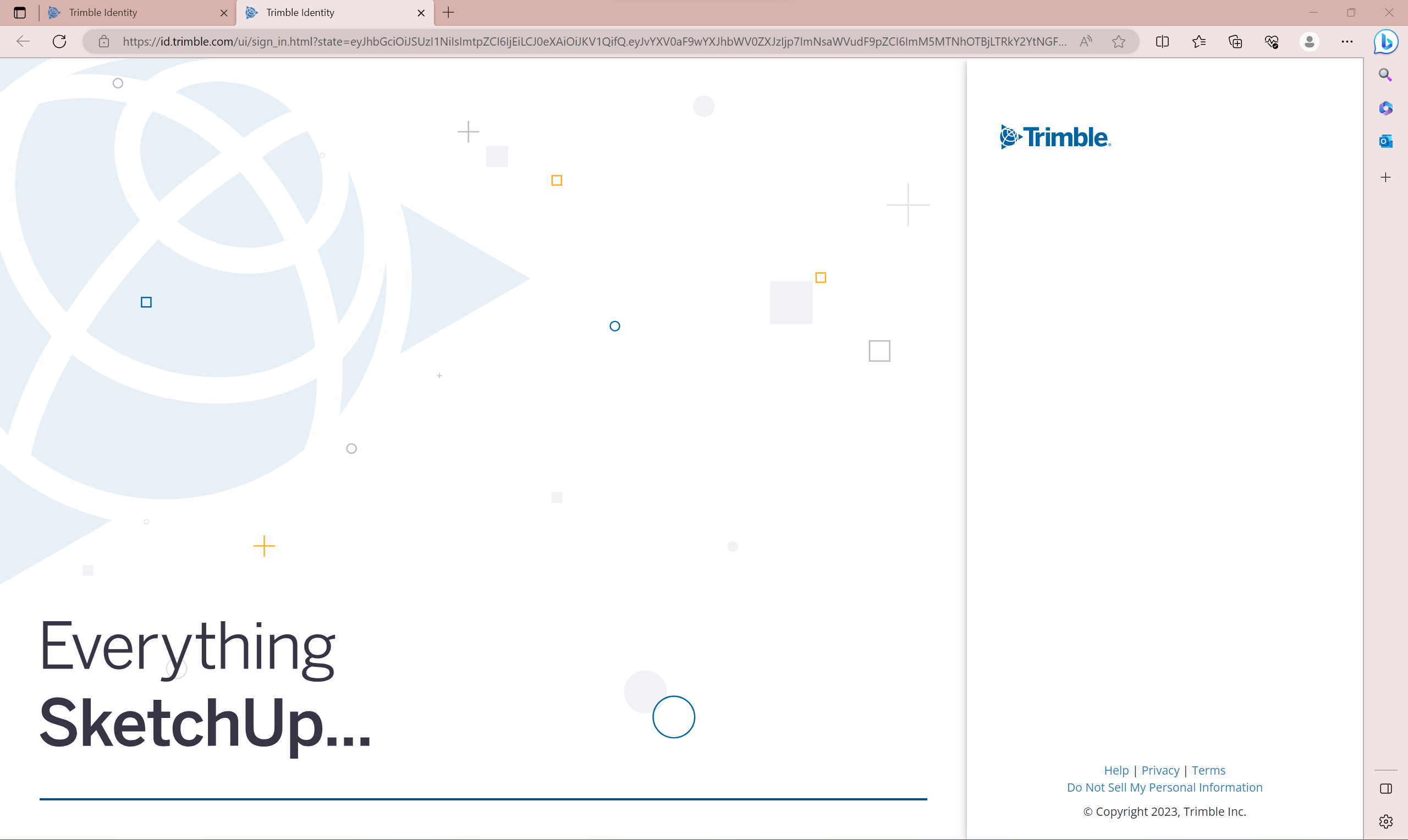

I can’t sign in either the program or the website on this laptop.I tried logging in on another laptop and using the same internet. It’s no problem. window 11. please help me.
That happens if you have a router or an ad blocker that prevents your browser from getting to id.trimble.com or accounts.sketchup.com. Either change your settings to allow those addresses, or try turning off the ad blocker when you want to sign in.
