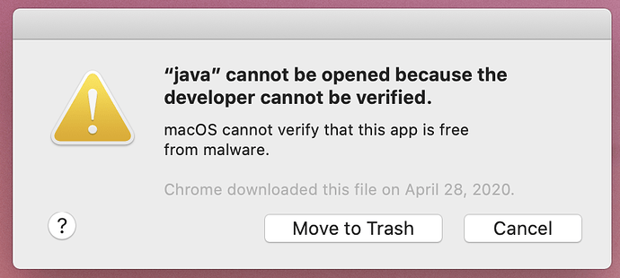

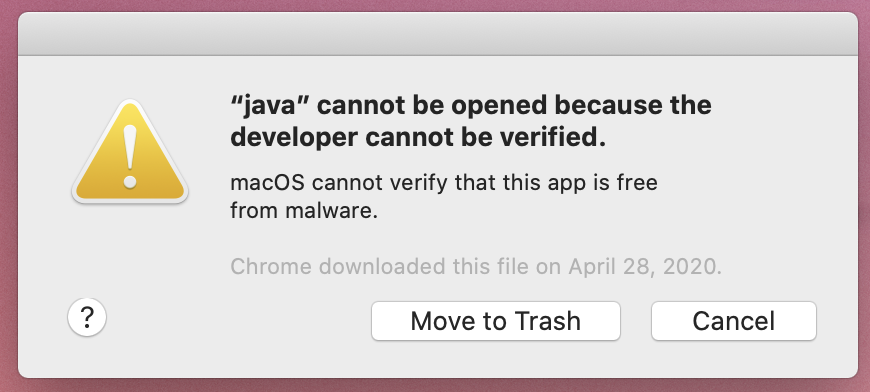

What do you make of this?
Archive: /Volumes/SketchUp 2020 Installer/Double-Click to Install Sketchup.app/Contents/Resources/Java/jre.zip

hi Colin & Team,
I’m also trying to resolve this java error. On macOS 10.15.5 with JDK installed. I get this error when attempting to install SketchUp Pro and my only option is ‘move to trash’:
Regardless of which button I click I get another prompt that the installer has failed and to ‘ignore, report, or cancel’
Hoping to find a solution to this odd error. Thanks in advance for your time.
Having the same issue here. 2019.3 installs but license is only for 2020.1 wich will fail to install!!! we need a solution asap!
