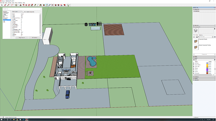

Post a screenshot of Model Info (top and bottom) or better still, share the model.
That model has a very modest number of edges and faces, but you have a pretty large number of unused components and materials. Purging the model might help performance, especially if any of the materials use large texture images.

@brandon.d.dodd’s screenshot of Model Info Statistics is a bit misleading.
Show nested components isn’t checked.
A checkmark in the box tells the whole story.

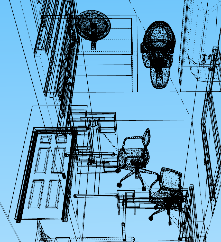

No amount of fine hardware can overcome the workload created by poor modeling technique.
The model in question has numerous issues that are causing it to lag.
One problem is overly complex components from the 3DWH.
Viewing the model in Wireframe with Hidden Geometry on reveals the stuff that leads to a laggy model.
Massive amounts of unnecessary micro-geometry.
