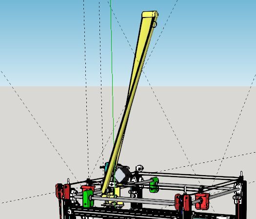

When I say that a component was relocated, I mean that it was suddenly
600mm from where it belongs. See attached.
that sounds like you need to reset the scaling on it and maybe other components…
if different items where modelled at different scale, then SU can get very confused even when orbiting…

60MB seems very large for any 3D printer model, have you purged the model recently?

What number of segments are you using on arc and circles ?
Are you drawing at full scale or 100x or 1000x ? There might be issues with small faces, etc. (SketchUp has an internal tolerance of 0.001 inch.) So this extra time “wheel-spinning” may be SketchUp choking on coincident points, etc.
It is often recommended to set the model units to meters, but think (and enter measurements) as if units were set to millimeters. Later when printing or exporting you can scale the whole model down 1000x.

This may very well be my problem. I am working 1:1 in millimeters. Some of
my component alignments are down in the 0.1mm range.
That would imply that most of the mechanical parts in the 3d warehouse are useless (well perhaps not useless, but need to be used with extreme caution). Most of them are drawn to various unknown scale factors and have to be resized to be the correct dimensions.
