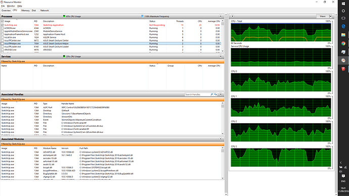

However, unfortunately, a soon as we fired up Sketchup on the new machine and tried it with her model it periodically hangs. It’s not crashing but becomes unresponsive, even when it is not doing anything and focus is on other applications. It happens with a very regular pattern every 5-10s and lasts a similar amount of time - see attached screenshot.

I have had a bit of a breakthrough though. I noticed that the problem only occurs when one particular layer was enabled. By experimenting with deleting some of the components in that layer I’ve been able to fix the issue. It seemed to come down to one plant called Salvia which came from the 3D Warehouse. Each one was 5.5MB and there were about 10 of them in the model. I removed them, purged and re-saved which reduced the overall file size down to 12MB.
So we seem to be ok now, although I’m not 100% happy as I don’t really get what the root cause was. Does it just come down to overall file size or could it have been an issue with that one component?
