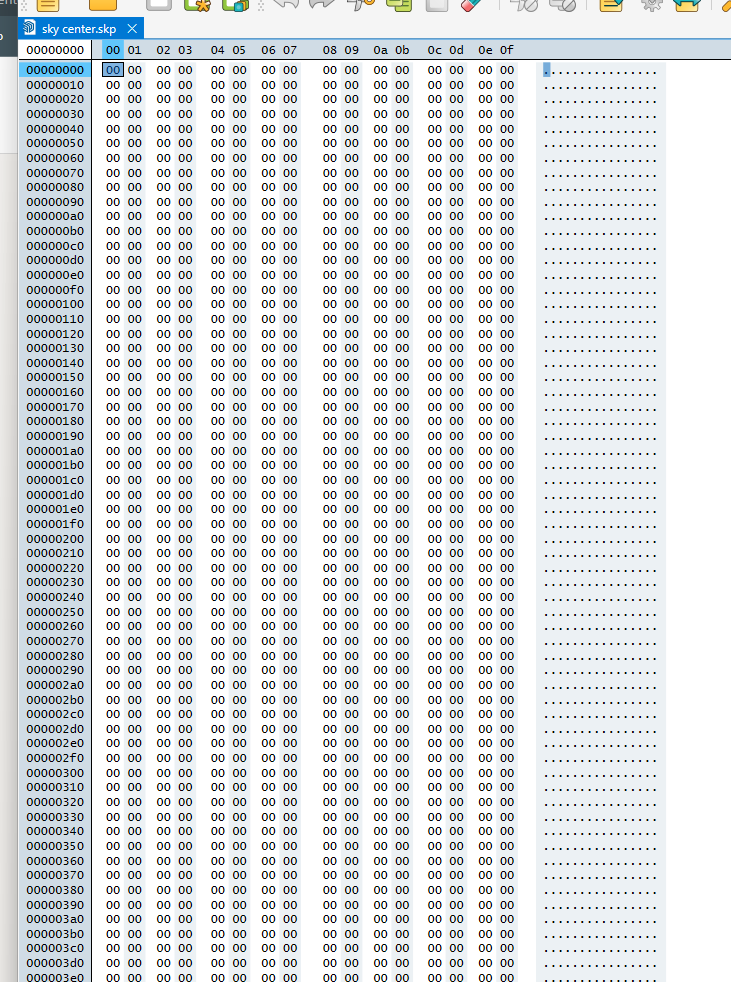

there is stuff indeed, but that’s not the structure of a sketchup file, just raw hexadecimal…

There’s nothing but zeroes in that SketchUp file.

Whatever happened on your computer replaced all the data in the .skp file with zeroes. We’ve seen this when the computer shuts down due to a power failure. Saving a copy to your Trimble Connect storage would at least give you a backup.

That file is also nothing but zeroes.
