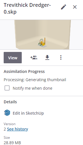

FWIW, included with your SketchUp subscription is unlimited storage on Trimble Connect. You might consider using it instead of an external drive (or other cloud service). You would still be saving to the internal drive but when you are ready to quit for the day or anytime you want, you would also use File>Trimble Connect>Publish Model to upload it to Trimble Connect. You’ll have the locally resident copy as a backup. Each time you publish the file it creates an incremental save so you can always go back to an earlier version if needed, too. Here’s one I had open and just published again. You can see this one has two versions available.
When you open a file from Trimble Connect it first gets downloaded to a temp folder on the internal drive. Saves are made to that temp folder so you aren’t relying on a web connection while you are working. When you publish the moel again it goes back up to Trimble Connect. You could also use Save as to save it into a non-temporary project folder on your internal drive if you want. This would be wise if you are also creating a LayOut file using the SketchUp file as a reference.
