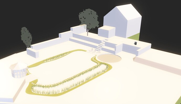

This next one is what the exported OBJ lookslike

It is logical that problems arise with the exported model because a lot of faces are incorrectly oriented, they should all be with the ‘front face’ visible (white outwards) and with the ‘back face’ to the inside.
