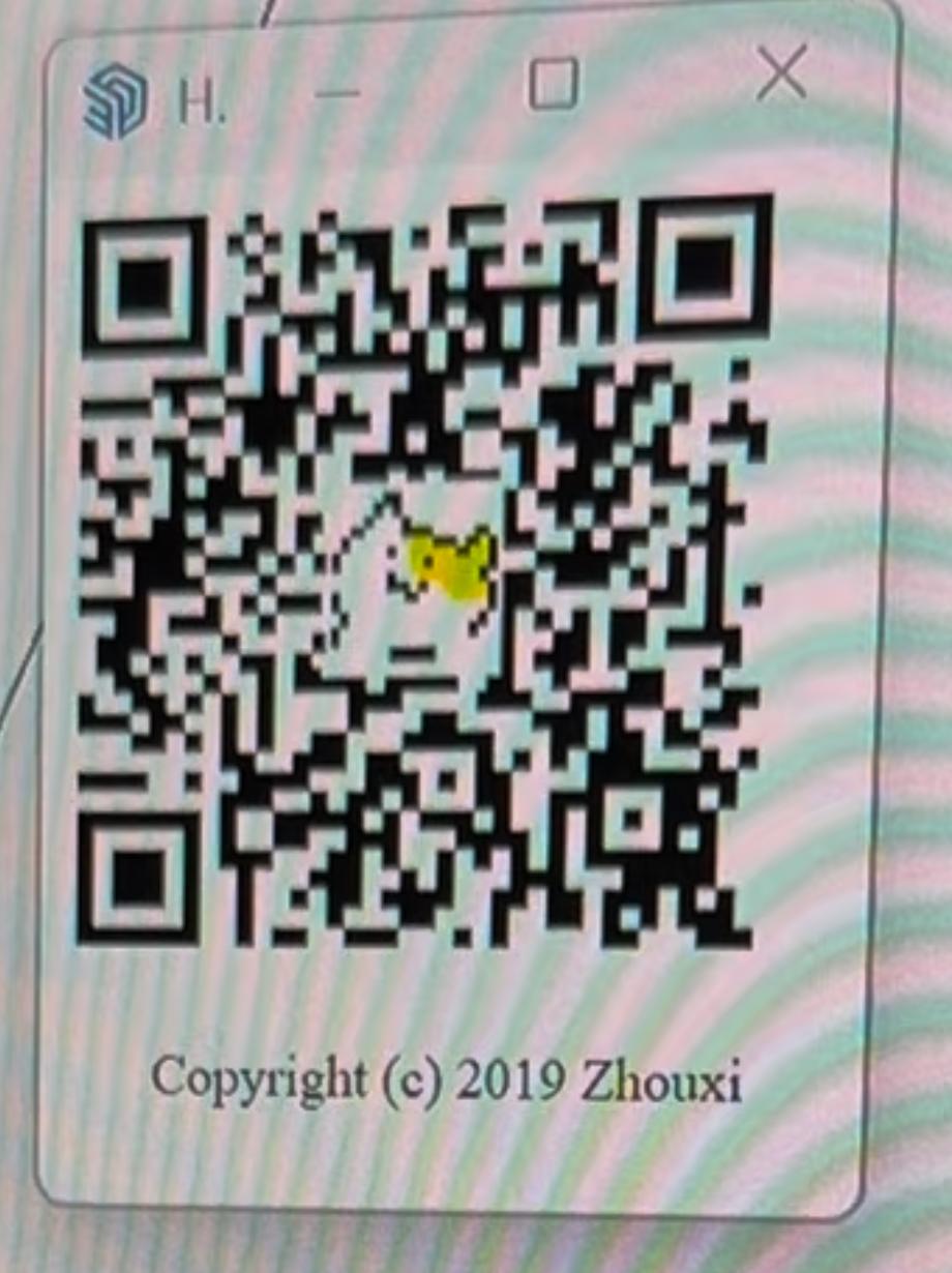

Quite often I get a QR code with a cat on the center, it’s impossible to make a screenshot cause it appears for less than a second then the program crashes, I got to catch it on video and tried to check where did the code lead to but it says that the site doesn`t exist anymore. It happens with different files or even empty files just while sketchup is loading after starting it.
After sending the bugsplat describing the issue i get this crash number.
this is a wechat QR code.

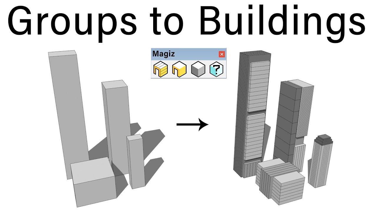

Looks like this profile doesn’t really exist:
Search suggests they are the author of the Magiz extension:
Apparently I had one, Mike hit the nail on the head, I´ve had it for years but it has been disabled for a long time, probably I activated without noticing it.
You hit the nail on the head, some how I activated it and I didnt noticed it.
