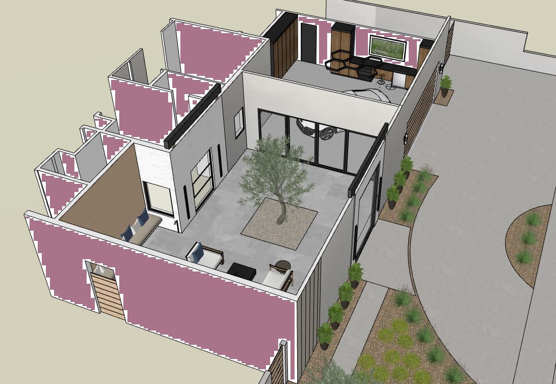

My sketchup model is started to have purple shading within boxes go on and off my lighter surfaces when I rotate. How do I fix this?
Something in your model is very far from the origin.
If it’s just the model you see in the image, move it closer to the origin. If it’s something else located a long way away, either bring it closer to the origin or delete it.
