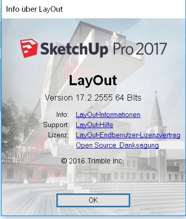

Version:
But the behaviour on LO’s Shortcuts-dialogue is the same as in the EN version.
What i did notice, is that not all keys are showing US-layout. Z and Y are correct, dot, comma, dash too.
