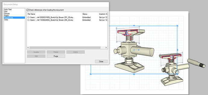

You can select anything in SketchUp, copy it, and paste it into LayOut. But, for each time you do that you end up with another model reference in the LayOut document, which could get pretty big. What Dave talks about gives you the same end result, with only one model reference.
In later versions copying and pasting from SketchUp to LayOut doesn’t copy all of the properties, either. For example, I copied the selected stuff from this model.
and pasted it into LayOut where it looks like this.
And because it is an embedded file, it is no longer connected to the original file.
And the file bloat after copying and pasting twice…
If you choose to use Copy and Paste this way, not only do you get unnecessary file bloat but changes to the model would have to be made in each copy which is harder to manage and prone to errors.
