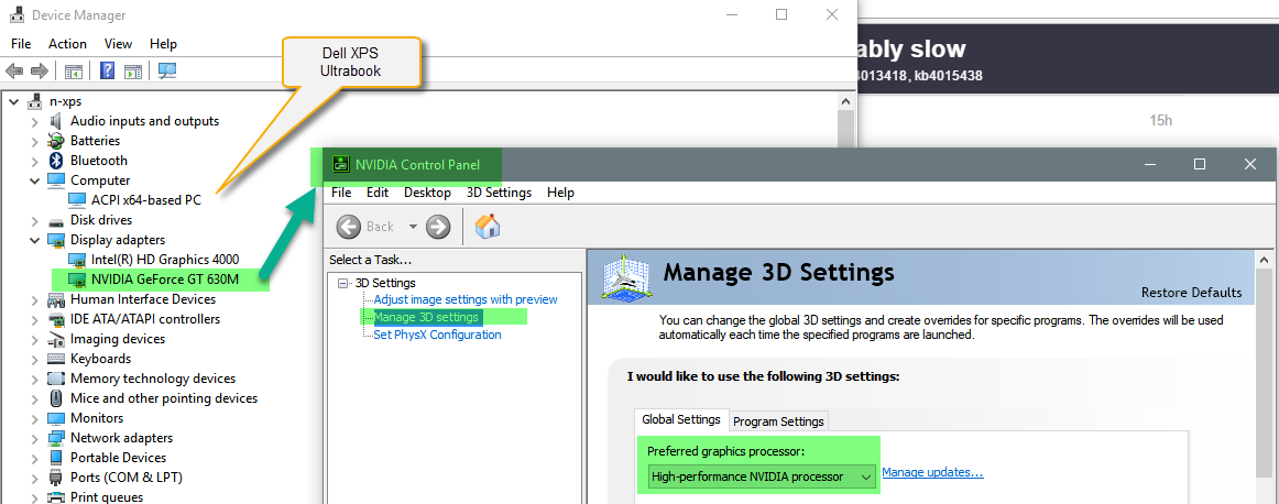

Solved for me by:
NVIDIA control panel > Manage 3d settings > Global settings > Preferred graphics processor = High Performance NVIDIA processor.
You shouldn’t have needed to go through the Global settings menu. Going the next tab over, to the program specific graphics setting to just fine tune the settings for SU, should have been good enough.

Global Settings sets your graphics options to be used for everything. Choosing the Nvidia card to always be used for everything will dramatically spike power usage. That’s not an issue with a desktop setup (it’s default), but it may become an issue for laptop users and how fast the battery drains when the computer isn’t plugged in.
To better manage power consumption on laptops, go to the Program Settings tab, select SU, and choose the Nvidia card for that program. Leave the global setting set to the integrated Intel graphics.

On my PC, SU17, Win10 with creaters uptdate i solved the problem by changing the settings in NVIDIA 3D Settings for Sketchup to prefers grafikprozessor to NVIDIA HighPerformence Pozessor. From this time it works fine.

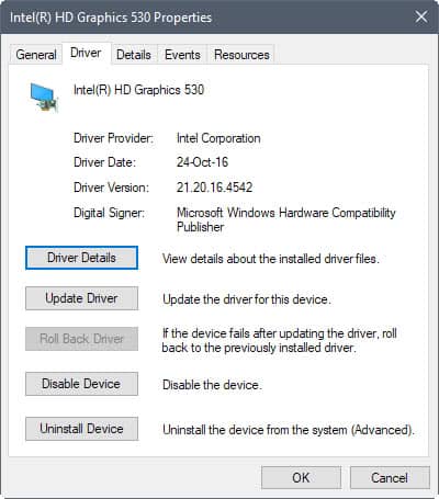

Driver Provider:Intel Corporation
Driver date:21/12/2015
Driver version:10.18.10.4358
