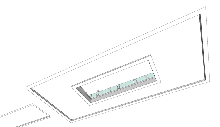

Looking for SketchUp native function/extension that would allow me to do below:
I have been looking for a tool that allows me to do this for a while now.
I want to select the highlighted rectangle or sometimes more complicated shapes just the ones on same Z axes that are connected. This example is selecting the outline of the void to create a cove with either Followme Tool or Profile Builder 2
So I can produce this eventually:
There are some that does similar, such as:
Select Curve - I live on this to select and clean up edges, but it doesn’t work for this purpose
Extrapolate Selected Edge - I just can’t get this to work, and seeing a dialogue every single time isn’t ideal
s4u-Select Tools - There are bunch of functions to select, but none does this selection ONLY
But I have not come across one that just does the job.
Shed me some light if you know any.
*Yes, it is only 3 more clicks in this example, but often it is much more complicated than that, and tricky-er when the model is more complex
