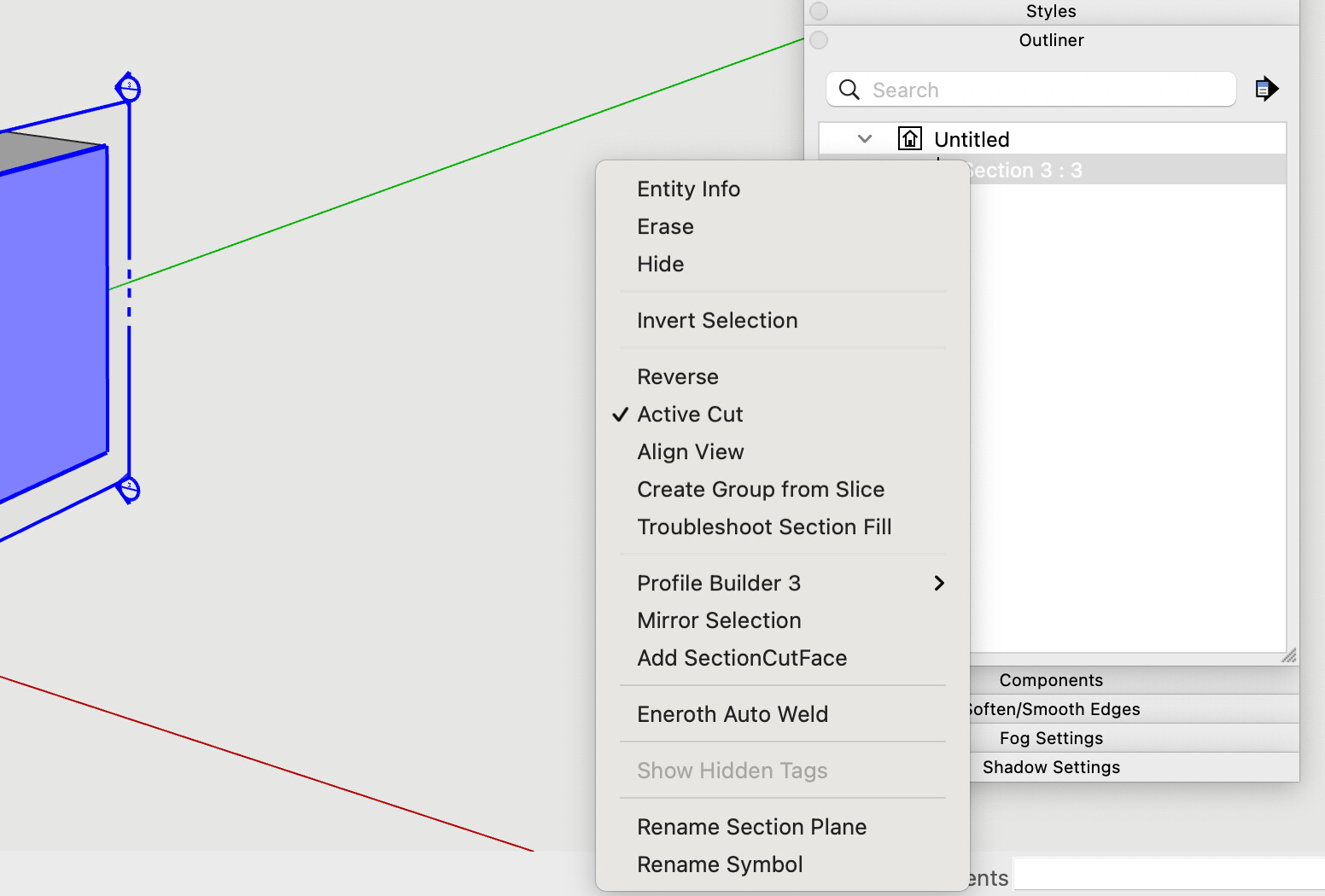

I did resolve my issue with my template but it required starting a fresh unopened file, with no section planes opened prior to save as template. It seems that once a file uses a section plane, even one, the next used section symbol/name is incremented by one. Even if one deletes all previous section planes, the next one starts from the incremented value.
So as you point out, manual methods are required for the succesive sections: either in entity info or the outliner via a right context click and scroll to bottom. Seems like entity info is easier.

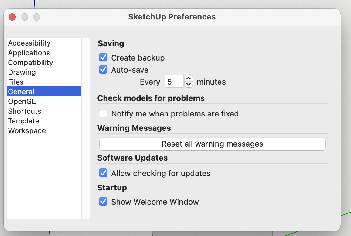

Also, one other thing I discovered, if you clicked on the Section Plane pop-up warning message “Please do not show this message again” and later you want to revert back to display the section messages, go to Preferences->General-> “Reset All Warning Messages” to restore them.
Some screenshots below in case it helps someone going forward.
