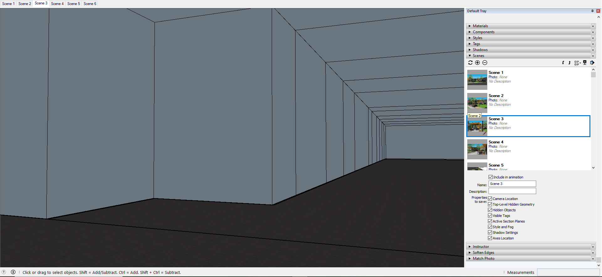

I haven’t opened this sketchup file in quite awhile, and when I click on a scene, it takes the model into the building. It takes each scene about 100 feet to the right of where I originally had it set. I’m dumbfounded because the thumbnail of the scene is showing the correct location. I’m thinking somehow my camera shifted? Any help would be greatly appreciated. Thank you!

It looks like the model was moved after the scenes were created but the scene thumbnails have yet to be updated. I think the fix would be to reset the camera to match the thumbnails as closely as possible and then update the scenes. When you update the scenes the thumbnails should automatically update.
FWIW, there’s a lot of incorrect tag usage. Most of it comes from the imported CAD file but it should be corrected.

I use a plugin from Sketchucation called Default Layer Geometry. You can also open the components and groups one at a time, select the geometry and in Entity Info change the tag to Untagged.
