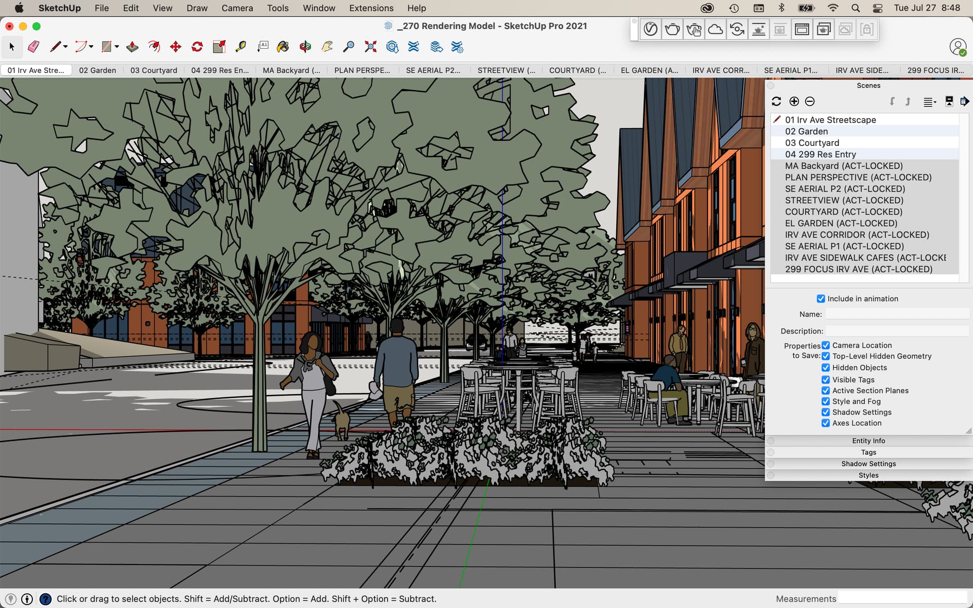

Yes. I used Advanced Camera Tools to set up multiple cameras that resulted in multiple scenes. Good for telling many stories about the project from different vantage points that can be developed as we develop the project.
See screen shots.

Did you reset the camera in the Advanced Camera Tools?
Deleting a layer / tag does NOT remove its associated objects, unless you specifically tell it to do so.
So if you have object “CameraX” assign to layer / tag named “Camera” and you delete that layer / tag, then “CameraX” is probably using “Layer0” / “Untagged” - so it’s no really ‘gone’ at all…

I just picked one of the scenes, reset the camera, then deleted the scene. saved and closed the file. when I re-opened, it was at the back of the scene list.
Seems crazy to be so deliberate and they won’t go away…
Sounds to me like the Advanced Camera Toolset is redoing everything again when you restart SketchUp ?
As Dave said, have you tried to reset things within that ACTool ?
After doing all of your deletions etc have you tried disabling the ACTool in the Extension Manager, then saving and restarting SketchUp to see if that helped ?
I’m sure you should be able to unset the ACTool’s Cameras etc…

Deleting the scenes would have taken care of it although it’s a little like burning the house down because it’s painted the wrong color. If the scenes were showing the gray bars you could reset the camera for that scene and then right click on the scene tab and choose Update. Normally the Camera settings are a property of the scene. You can revise that any time you like by updating the scene after making the changes.
