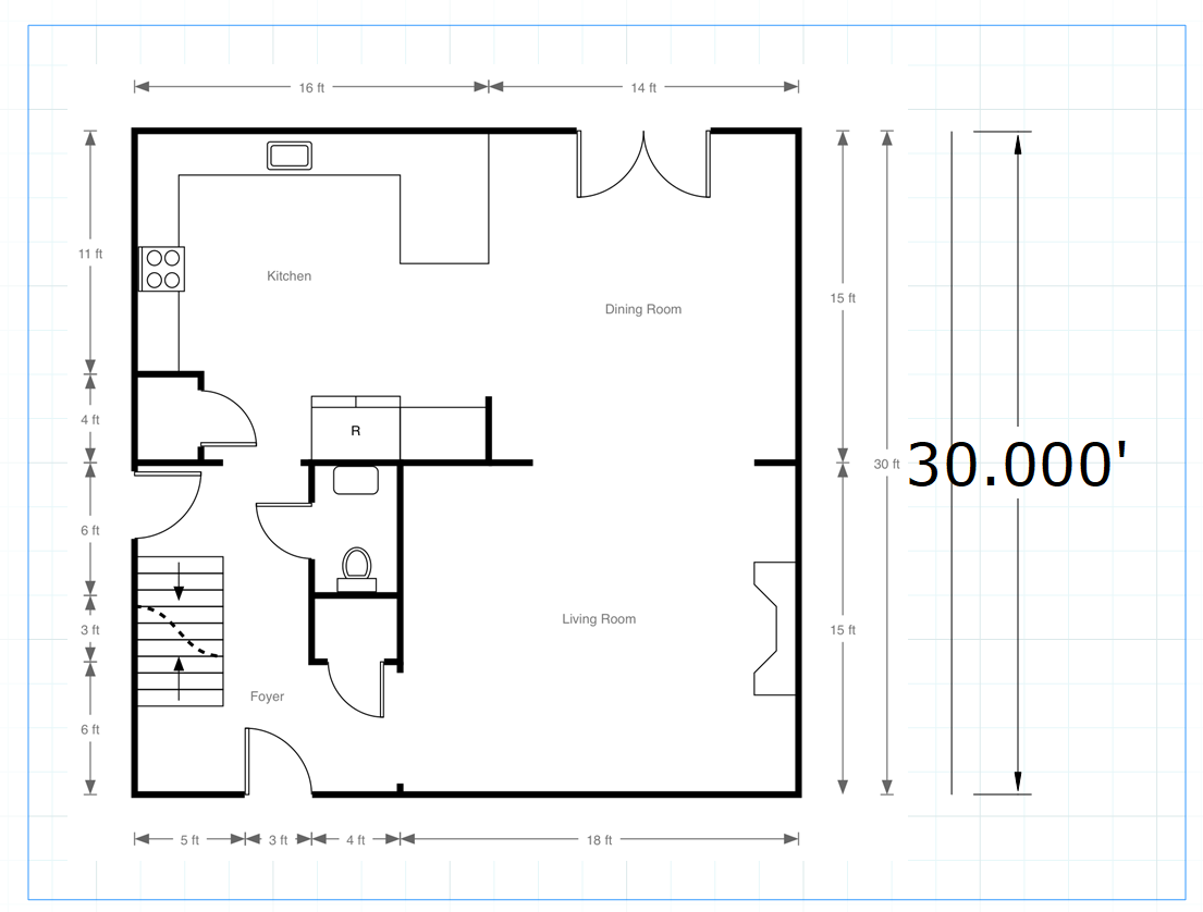

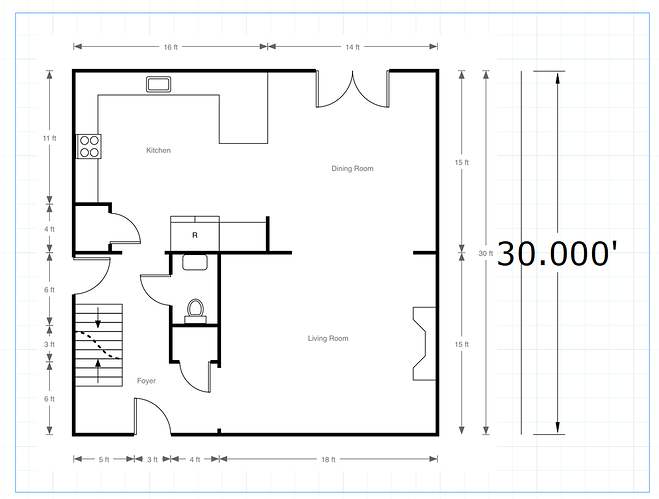

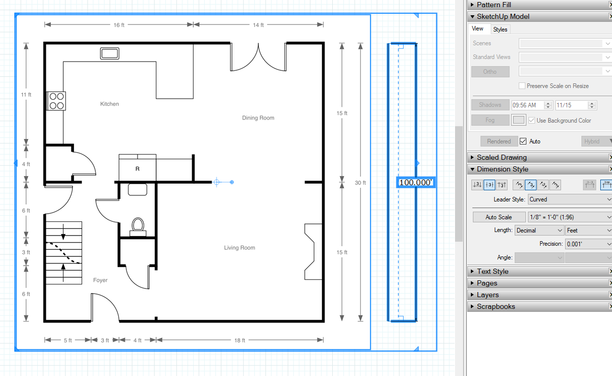

One way you could do that is to the imported JPG file and a scaled dimension together. I drew a line to dimension but it isn’t really needed.
Then resize the group by dragging a corner handle while holding Shift until the dimension shows the correct distance.
