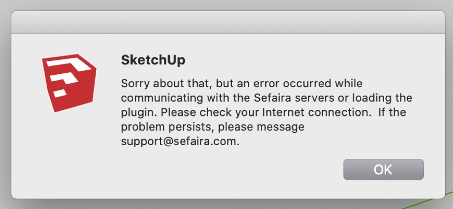

This time, however, when I drop the .jsor file into the tmp folder, the tab for Extentions disappears from my Sketchup toolbar. After a while, the following message appears:

Hi there, I have made sure repeatedly that my SketchUp was closed. I have also noticed that the complaint has been made on the original post:
Here is the screenshot:

I have shown that dialog to Niraj before. It happens when you have Windows set to the highest security level. Choosing Medium then avoids the dialog.
I wasn’t able to find a setting on Mac that causes the same error, but maybe you have. Think about what your security settings are on.

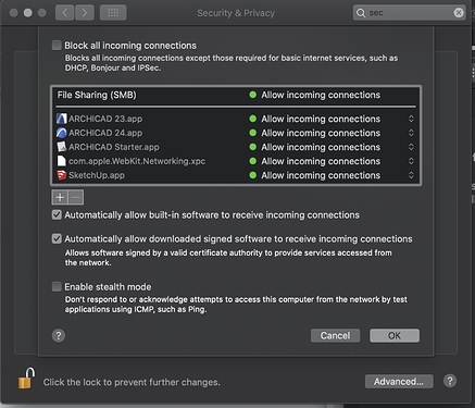

So after you both suggested that I take a look at my Safari security, I fiddled around a bit and I managed to get my Sefaira running again. I suspect it has something to do with Apple’s tightening of security, especially when it comes to Safari.
I have disabled the Firewall for Sketchup in System Preferences under Security & Privacy and I have downloaded the extension and .jsor again and followed the instructions as above.
