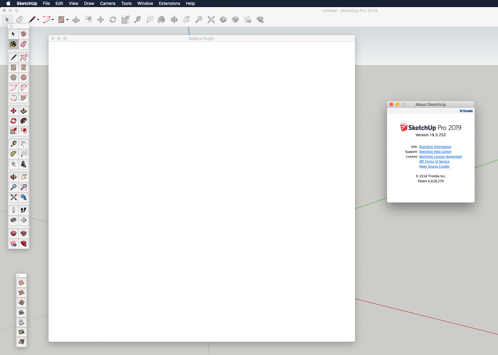

When launching I’m greeted by the “Loading Sefaira Plugin…” which quickly passes, this is followed by an empty “white box” as shown below.

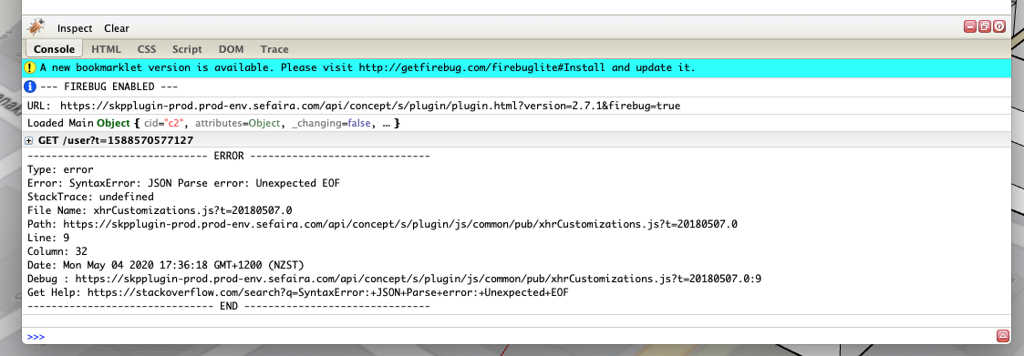

A couple of notes, the firebug console is giving me an error as you’ll see, unsure if this is related.

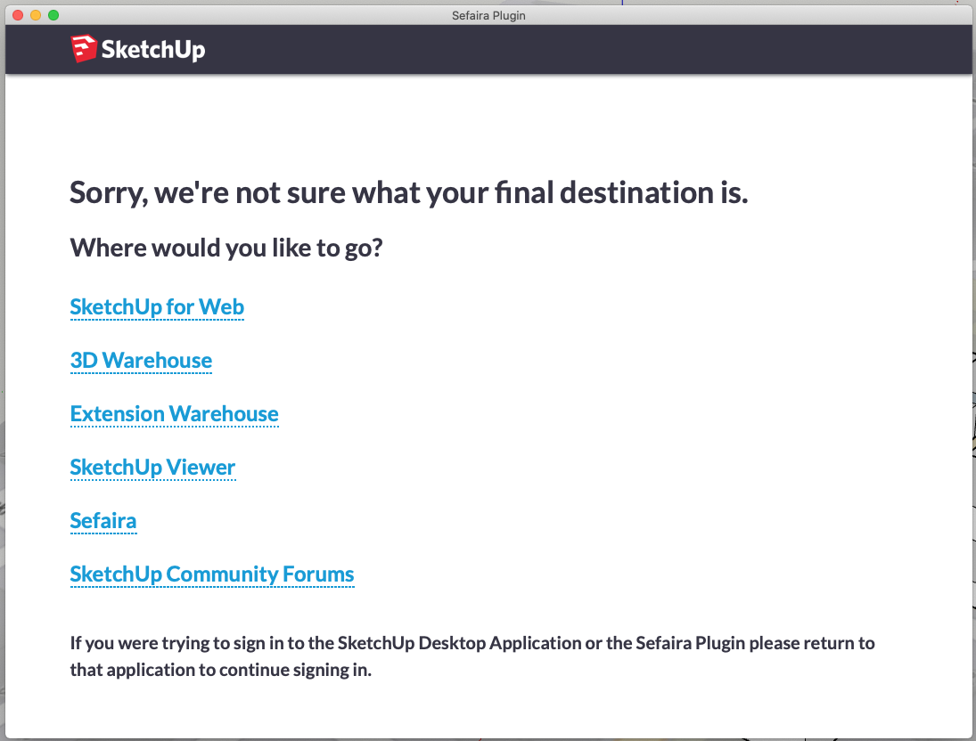

After I pass the expected Trimble login page I either get the same white box I had been getting or the page displaying “Sorry, we’re not sure what your final destination is.” If I select any of the options on the page I get redirected to the given webpage selected, obviously not where I want to be.

Error, but when pasting the required line it continues

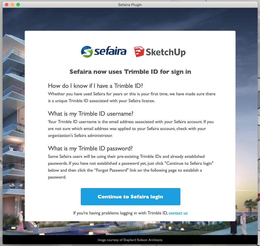

Greeted by a login page
There are two more login pages that continue as expected - didn’t include them as they have personal details.
Here I either get the show page or the plain white box,
