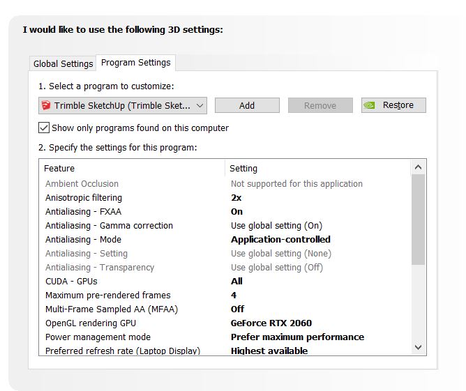

Here is the settings I have set. I have just been adjusting and checking if anything changes but nothing has so far. If anything looks wrong you can let me know.
I restarted my computer in the last attempt and still no visible change.

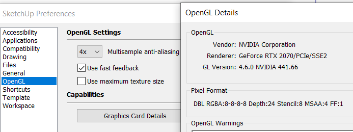

My SketchUp OpenGL settings:

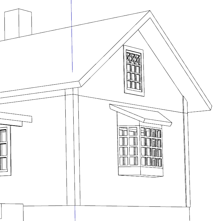

A screenshot from my SketchUp:
I am running it at 16x with the fast feedback selected. I guess you have some jagged edges, but not as bad as mine. Maybe I am just picky.
