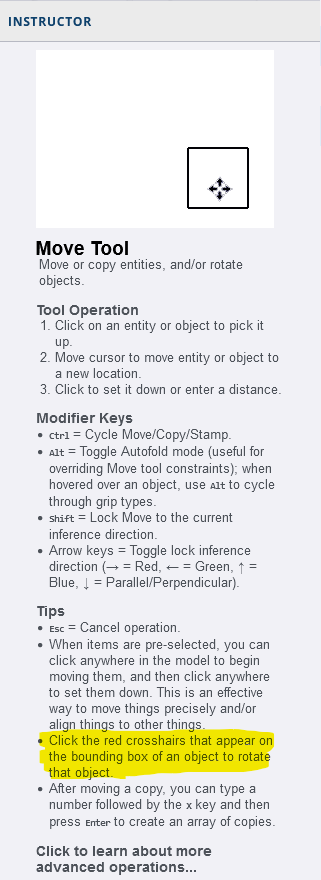

The instructor still tells me this is a feature of the move tool:

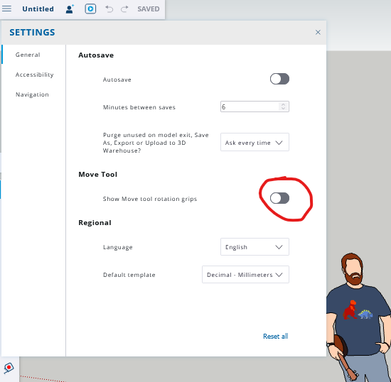

It is a new feature, many people hate the rotate option so they have given us the choice.
Look for it in App settings.

Thanks a bunch! This saved my sanity!
How anyone could hate that tool option is beyond me, but guess that’s the feature of subjectivity :smile:

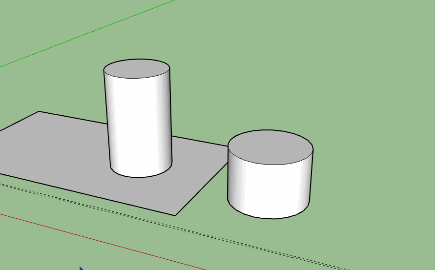

I turned it on, and it worked fine for a while, but today it seems to be “stuck in the middle”
I can rotate objects on 2 of the the 6 sides, top and bottom, only. It does this for both groups and components. I tried to restart, turn the option off and on, download the model and reload, nothing works.
Thanks for the post @DanielH. That is definitely not intended behavior. Is it possible for you to share the file with us so we can take a look at it and see if we can figure out a solution? If the file is not something you can share, I totally understand and would settle for a short video or even a screenshot so we can get a better look at things.
I’ll bet the component you are trying to rotate has gluing properties set. That would prevent rotate handles from showing on certain sides of the object. Or it could be that you need to orbit the camera a bit first. As Casey requested, share the SketchUp file.
Tall cylinder is glued to the rectangle. The only rotate handles available are on the top. The short cylinder is not glued but the camera is oriented too close to the front to be able to access the rotate handles on the side. Orbiting the camera solves that.
