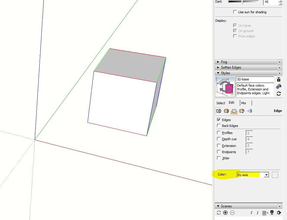

To check if your lines are on axis you can set your styles to show all linework in red, green or blue to match your axis
helps you identify which ore off axis.

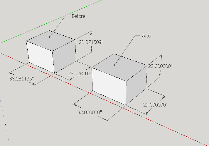

Thanks GSharp, in Retrospect, you are correct and if I had to do it again, thatâs exactly what I would do, the problem I have now is that I have put hours of work in that I dont want to repeat. I have been using the âcolour the axisâ Style which as you say is very useful for the obvious but there appears to be a bug in SketchUp where it is possible to have all the axis show in green, red and blue but still no face and of course all the measurements indicate âspot onâ. It is only when I change the units to 0.000 and remeasure it now shows 10.001 or 9.999 instead of 10, changing the units back to 0.00m and measuring then shows 10.00. Somehow the internal storage precision of points does not always represent the algorithms that are used internally to decide whether something lines up or not. This is why I really need a utility or plug in to readjust the drawing.
I have run into the âby axisâ inaccuracy as well a few years ago. Thereâs some âsecretâ margin it allows while still showing âon axisâ. I donât use it anymore.
Internally, SketchUp uses inches as unit. So if you type 10m, internally its stored a X.y inches. My way to prevent dimension errors as much as possible, is to use mm as unit and precision set to 0. This works fine for me in my daily work as an architect.
As far as I know (having used SketchUp for almost 10 years now), thereâs no plugin that re-snaps your drawing to some grid.
Maybe you can just make a separate drawing for your details and insert them into this drawing as a component? That way you can work in the detail drawing using the 0 mm precision, while not having to re-model the house. Just an idea.
There may be a common misconception involved here: the units setting in Model Info affects how values are formatted for display, it does not have any effect on the actual values themselves. Setting 0mm units wonât change any SketchUp calculation in any way, it will just cause it to drop the fractional part when displaying dimensions etc.
