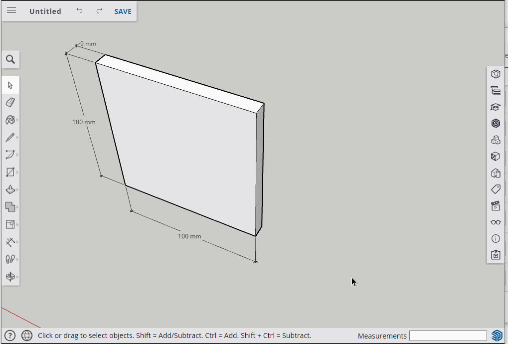

Hi, I am struggling with this again.
I mainly work with wood, so I have a “plank” of wood of 9mm x 100mm x 100mm. I would like this to be 9mm x 120mm x 100mm but with the tape measure it resize everything. I understand this make sense for components that should not lost its proportions but for a piece of wood I would like it to be more flexible.
The only way that I found to do this is calculating the scala that I need and resizing by this scale, but this is very slow… I trust it shoud be an easier way!
Thanks!
Fer
Certainly there are easier ways. If you are absolutely set on using the Scale tool, enter the dimension instead of the scale factor.
scale
Or use Push/Pull on the end face and add 20mm.
Push
Oh dear it was easy… :rofl: thanks!!!
