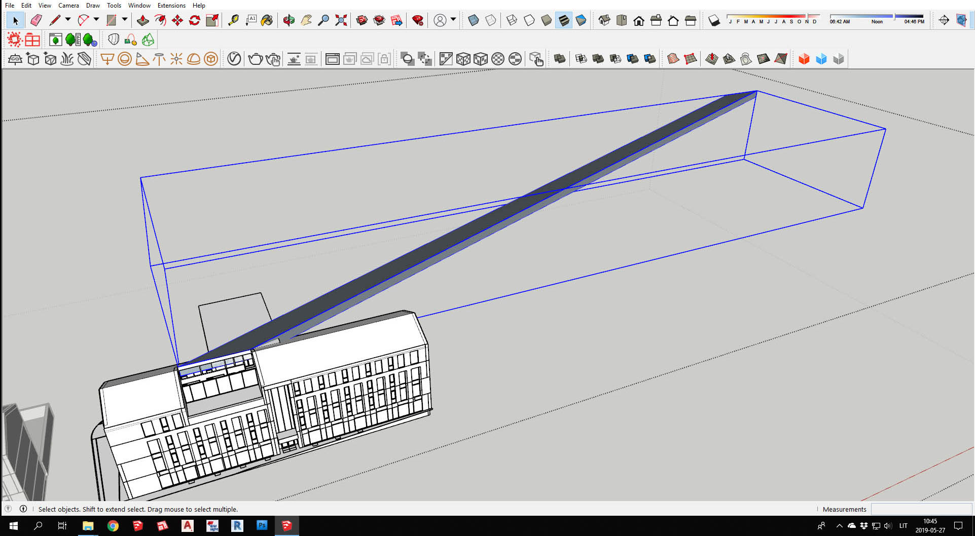

I’ve been using SU for a few years now without any issues, but after installing SU2019 I’ve ran into one.
When using move tool on an edge or a surface sometimes the selected object jumps somewhere far and it’s not possible to undo that. Undo works on steps that were made previously but doesn’t bring the moved geometry back.
This happens a few times per day on different projects and is extremely annoying when working on a more complex geometry, because after the jump you have to choose - reopen the project and loose some work or remodel the broken geometry.

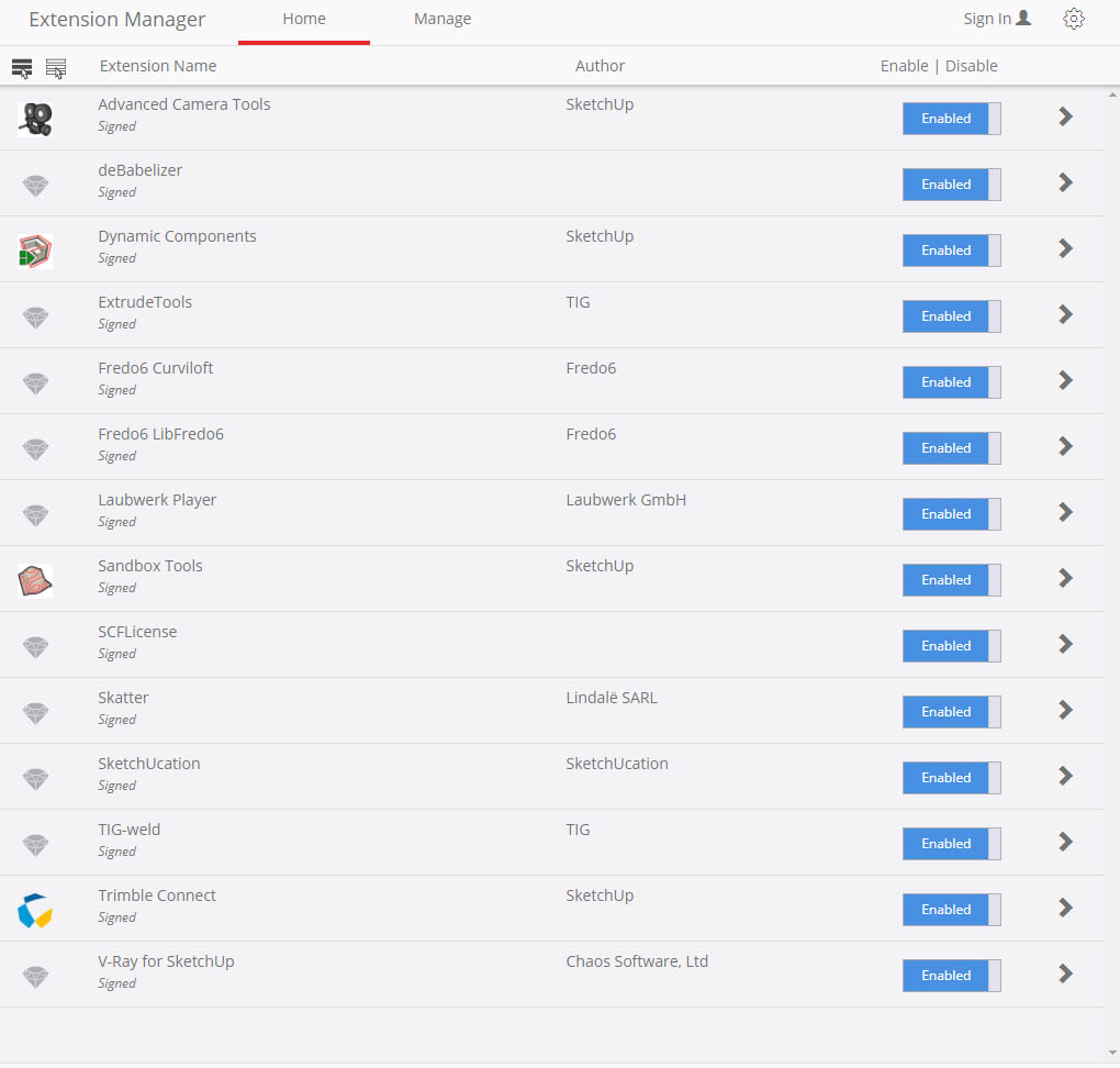

What extensions do you have installed?
I’ve heard of similar things happening due to one of the extensions to cut an opening through a multi-layer wall. I can’t remember which was the culprit or find it in a search, but if you have such installed you might try turning it off.
I’ve attached a screenshot of extension manager.
Before making the screenshot I have uninstalled shape bender by Chris Fullmer because it doesn’t work on SU19 anyway. We’ll see if that helps.
It does if you install the updated version found on the EW.
Good to know, thanks!
