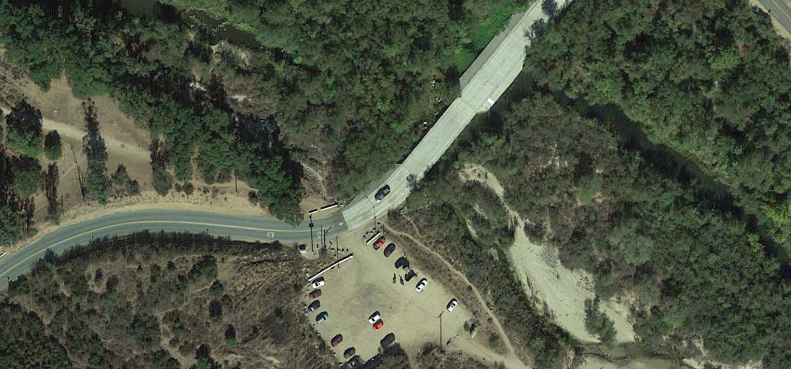

I have a surface with an image projected onto it as a texture for realistic terrain modeling. Everything matches up and looks good, but I’m not happy with the resolution of the terrain. The sketchup version is much blurrier than my base image. I have attached jpg’s of both to illustrate. Am I doing something wrong, or does sketchup only support a certain resolution? BTW I have sketchup pro 2016.

Hello. Look under the OpenGL settings from the System Preferences menu. The “Use Maximum texture size” might be of help. I remember enabling it would make my textures and images crisper, when I was testing it years ago.

Thanks! That worked perfectly! Thanks also for your prompt response!
