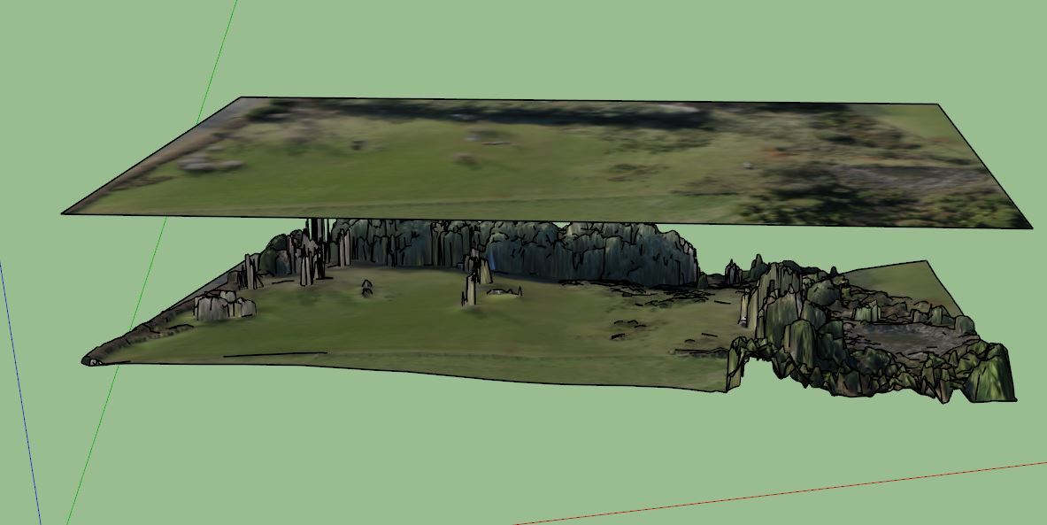

I just made a surface from contours and overlaid the same image.
If i apply it within the component editing context, it works fine, but if i do so externally the result is similiar to my other issue.
So I’m guessing it has to be due to the component being made up of so many faces.
Applied externally

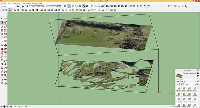

@Box : I really thought we had it that time, it was all looking different and promising up until i actually applied the texture. The texture still had similiar issues, but in a different way. If you compare the image above to the surface it’s been applied to the geometry is all over the place.

Trim off the clear parts of the image and it works fine.
Well done @Box!
Using the method you described before? or just the standard method?
Works OK here.
Albeit, the mesh isn’t what one would term truly functional terrain.
There are overlapping faces here and there and many odd depressions in the mountain peaks.
On the model you uploaded I just reversed the face, exploded the image, trimmed of the clear triangles and used the paintbucket.

Far out, i seriously think the only step i didn’t do was clicking on the thumbnail in the materials dialogue box after using the sample paint tool. I just sampled and then used the paint bucket straight away.
I wonder why that caused such and issue?
